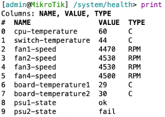

I am trying to install CCR 2216-1G-12XS-2XQ in my homelab, but the noise levels even without a single SFP port is in use is too high.
See attached screenshot or values below:
[admin@MikroTik] /system/health> print

This is when the device is completely idle, not a single port in use (apart from MGMT ether).
Any suggestions on how to reduce the noise? The rack is literally 1m away from my head at home, I have another 3 servers and a wireless router and none of them make nearly that much noise, even when at 100% utilisation.
