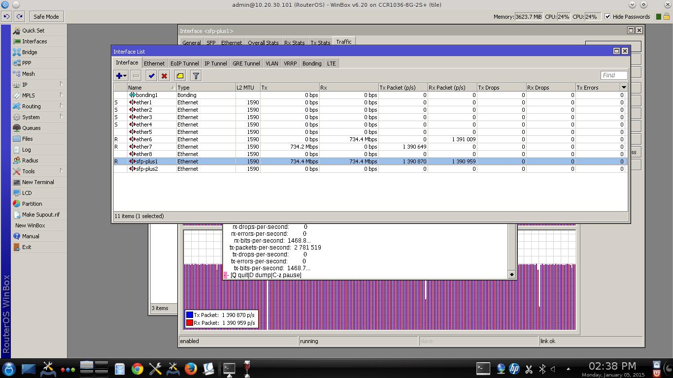

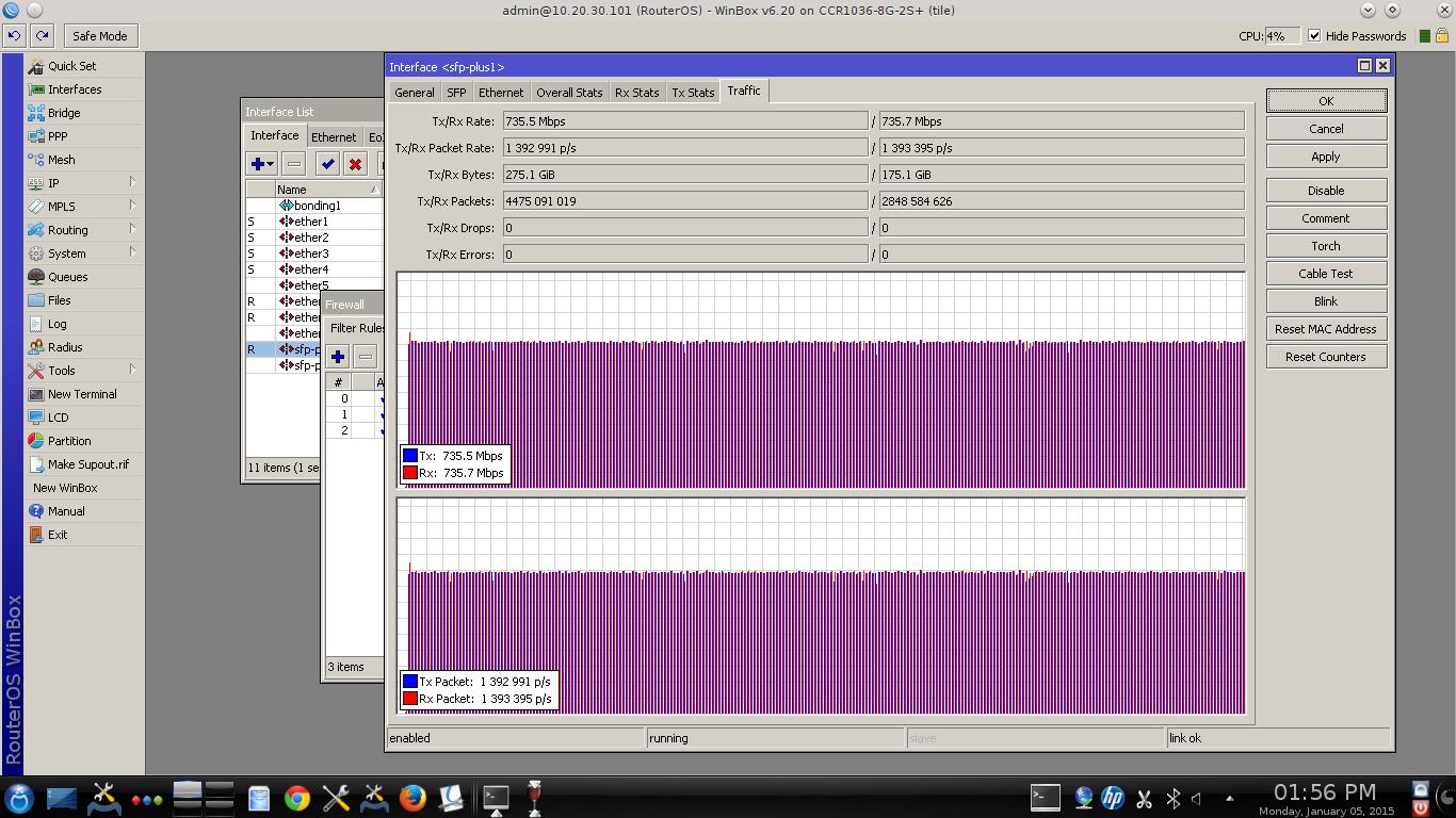

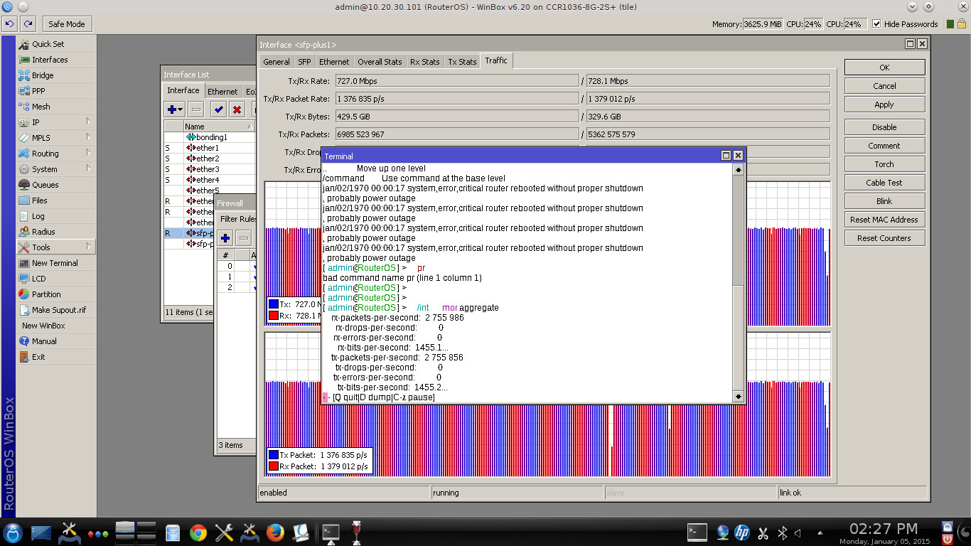

here is my test running with 4 xeon server with iperf, packet size 64b, proto udp and 10 parallel connection. It reached 2.7Mpps, cpu usage 25%. Though it showed erroneous cpu usage under winbox title bar after doing the tools profile the cpu usage got corrected too.
Config :
allow fast path off
conntrack on
3 firewall rules (on rule all traffic accepted on forward chain)
3 simple queues with dst 0.0.0.0/0
Screenshots attached.
Looks like i’d hit another soft spot of CCR. On the above test I found that no traffic was passing thru the queues. I disable all queues and enabled just one queue with target 0.0.0.0/0 dst ether6 max limit 900k and there it goes. The cpu usage rose to 100% winbox disconnected no telnet no ssh. I was unable to make support file.
