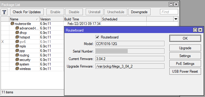

Can anyone confirm that the latest firmware available for CCR is ‘tilegx_3_04_2’ ? or is there a more recent one?

when you install newest RouterOS, the RouterBOOT (firmware) is included with it. Just check in your “/system routerboard” menu.
currently 3.04 should be latest
When i upgraded RouterOS to v6rc9 Mikrotik informed via Forum that it was best to upgrade the firmware and as so i downloaded and upgraded the fw at that point in one of the Lab CCR’s
I was unsure that the firmware was included in routerOS upgrade package i’m already in rc11
The snapshot is from one of the CCR’s that took the manual firmware: ‘tilegx_3_04_2.fwf’
Nevertheless thank you for your answer, that way i won’t bother checking for the firmware since i now know it is included and that 3.04 is the latest.
