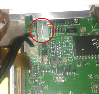

does someone know if the socket on the attached picture could be used (or is maybe designed) to connect a secondary PSU?

yes, other PSU can be used. Just note that PSUs have to provide different voltage, minimal delta should be no less than 1V, to be on the safe side you can go with 2V difference.

Hello, I want to know secondary PSU can plug on ALL CCR series routers?
yes they all have secondary connector on the PCB. You can open the case and check what power connectors exactly your router has.

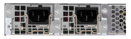

If I had a wish regarding the features of future CCRs, I would like to see that:
  • Redundant, hot-swappable PSUs
  • AC and DC PSU option
  • hot-swappable fan tray with fan redundancy
  • Power Plug retainer clips
  • PSU Status via SNMP
    That would make the CCR Series real carrier class routers.
if MT ake a psu nr2 option, and provide a hotswat option to this, the CCR would (after software upgrade that is consider as stable) be the best broadband router at marked today ( at a price the 90% smallest company could afford)
