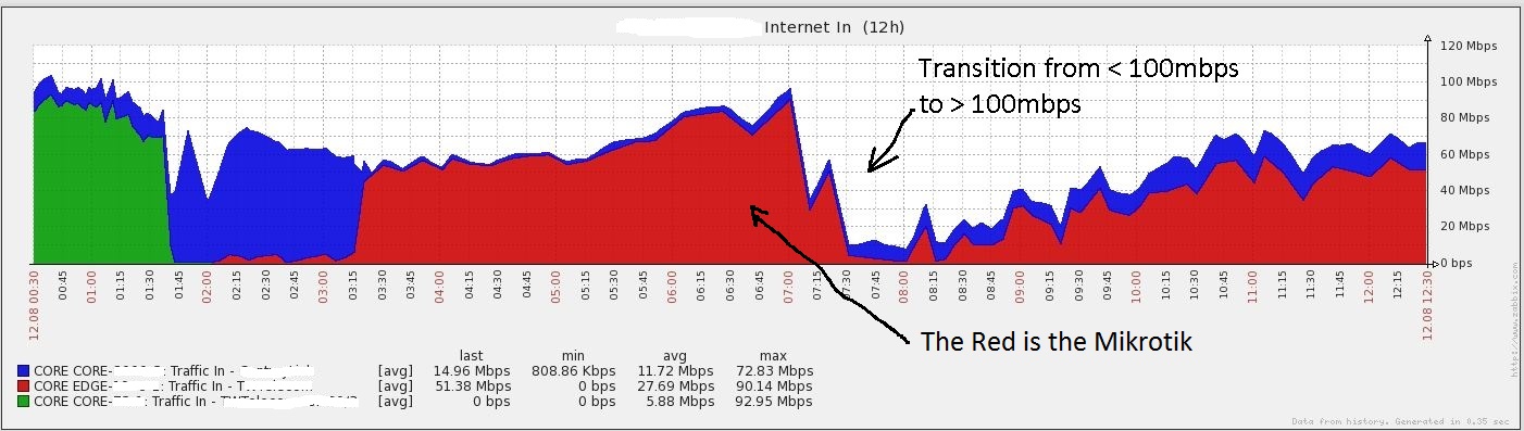

I am experiencing issues when querying bandwidth stats on the spf1 interface if a CCR-1036-12G-4S running v6.2 of the OS. I am not sure if this applies to all interfaces or only the spf interface.
When the interface has traffic exceeding 100mbps it truncates the speed. Example: when the router is receiving 140mbps on the spf interface my snmp query is reporting 40mbps. I am using the ifInOctets (1.3.6.1.2.1.2.2.1.10) and ifOutOctets (1.3.6.1.2.1.2.2.1.16) for my queries and a multiplier of 8 to get to bits.
Has anyone else experienced this issue? I have seen others post where they have CPU issues relating to having SNMP enabled, but I have not seen what I am describing. I have sent in a trouble ticket with MikroTik but have yet to hear back from them.
Gilbert
This is likely an issue with your snmp poller and not related to ROS or CCR - you need to be using 64-bit counters at those rates. Take a look at ifHCInOctets (.1.3.6.1.2.1.31.1.1.1.6) and ifHCOutOctets (.1.3.6.1.2.1.31.1.1.1.10)
I will try that. This is the first time for me to have this issue. I am switching from an old Cisco routers I had at the edge to Mikrotiks. They had all polled ok at the same speeds.
That did solve the issue. I am now getting accurate values. Now this is only for the spf interfaces, correct or should this be also used on all gbit interfaces?
You’ll need to do this on any gigabit port you are monitoring.

Thanks for the helpful post. This has been burning me for a while now. I had Cacti set for IN/OUT Bits Per Second Total Bandwidth and all my interfaces exceeding 100mbps were clipping.
I had to go into Graph Management, select the device to filter, and then selected each interface and DELETE. I also deleted the associated data sources.
I then went into Devices, selected the device, clicked on Create Graphs and re-created the graphs for each interface I deleted. However, I used IN/OUT Bits Per Second (64-Bit Counters) for all the new graphs.
I lost my historical data, but I’m getting accurate results now.
