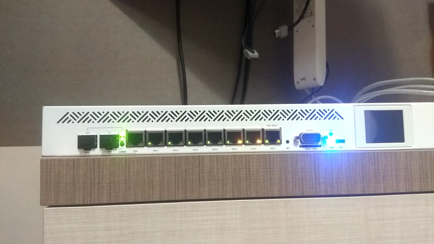

Running CCR1009-7G-1C-1S+ with latest stable 7.16.2
Ethernet 4 port does not have the orange status led working, port seems to behave OK, links in 1gb and the link led works
When turned on not all ethernet port status leds flash.
See this pic
eth no link/status led
eth1 to 4 no status led
eth 5 and 6 both link and status leds light up
eth7 both leds light up but status led green? (expecting orange in in eth5 and 6)

I really don’t care much if all status leds flash on boot, my main problem with this is that status led on eth4 does not light at all on cable plug
The rest of the ports status leds do light when cable is plugged in them

Issues persisted. More then half of the ether status/activity leds do not flash on turn on
eth4 status/activity led does not light up on cable plug

Capacitors on board look fine, none swollen/cracked/etc. any of the usual signs of them going bad.
Noticed that status/activity led of eth7 is little dimmer than the rest of ethernet ports so I guess its about to go out as well. Maybe this is what happened with eth4 led, it just went bad.
Interest remains on why the activity/status leds of most ethernet ports do not flash on startup, even though they light up on cable plug.

The unit reports factory ROS 6.45.9 which is not officially listed in the download section no more but with little URL tweaks I managed to get it off Mikrotik together with the netinstall software for that version. However, for now I’m staying with latest long term 6.49.13. It is my belief that eth4 status/activity led has just gone bad as
  1. All other eth activity/status leds light up on cable connect, only eth4 does not
  2. I’m seeing eth7 led going dim, the other eth leds are way brighter than it, so eth7 led is gonna go bad sometime soon too I’m guessing
And in regards to the majority of status/activity leds not flashing on startup I’m guessing this is an early bug. I would’ve never saw it unless I had the unit in front of me to play with.
In its previous life its been in a rack with all interfaces hooked so this behavior was never paid attention to.
