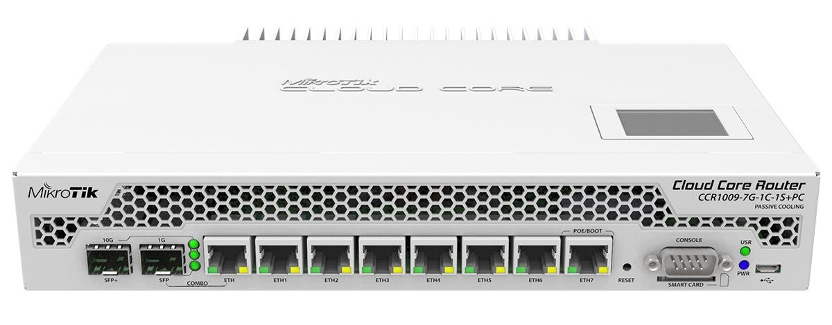

https://images-na.ssl-images-amazon.com/images/I/61lsSYq1pTL._SL1200_.jpg
here is a image of the ports of my router, I know there are more than 1 CCR1009 model, maybe they are different somehow, I don’t know…
Yes, I gave up on SFP port implementation by mikrotik and purchased a media convertor which converts ? my fiber optics signal into simple 100mb ethernet which I then plug into second from the left port, marked eth1 on the image above.
My question is, how to make the first left eth port (marked eth, or the ethernet part of the combo1 port if you wish) work as a input from my media convertor?
At the moment I have input coming into eth1 port (second from left ethernet port) and I am left with only 6 ports (eth2-eth7).
You can do that.
But you need to move all existing “wan” config from eth1 to combo1.
For reference do an /export in terminal and look for all the places where eth1 occur.
Even better way would be to drop default configuration at all and configure the whole router from scratch, but that’s only if you have at least some basic mikrotik experience.
