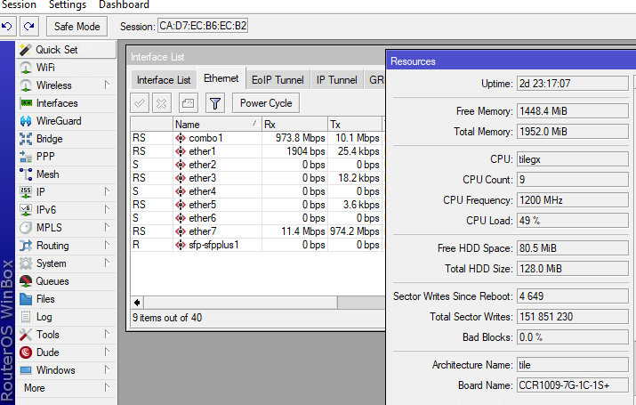

I see over 900 up and down on my 1gig fiber connection, CCR1009.
That is a different model! And different config as well.
Thank you for the input.
What is the combo port on your router?
He has a different model. CCR1009-7G-1C-1S+.
It is the later model. It does not have the ether1..ether4 switch. So the issue you are seeing is not present on that model.
