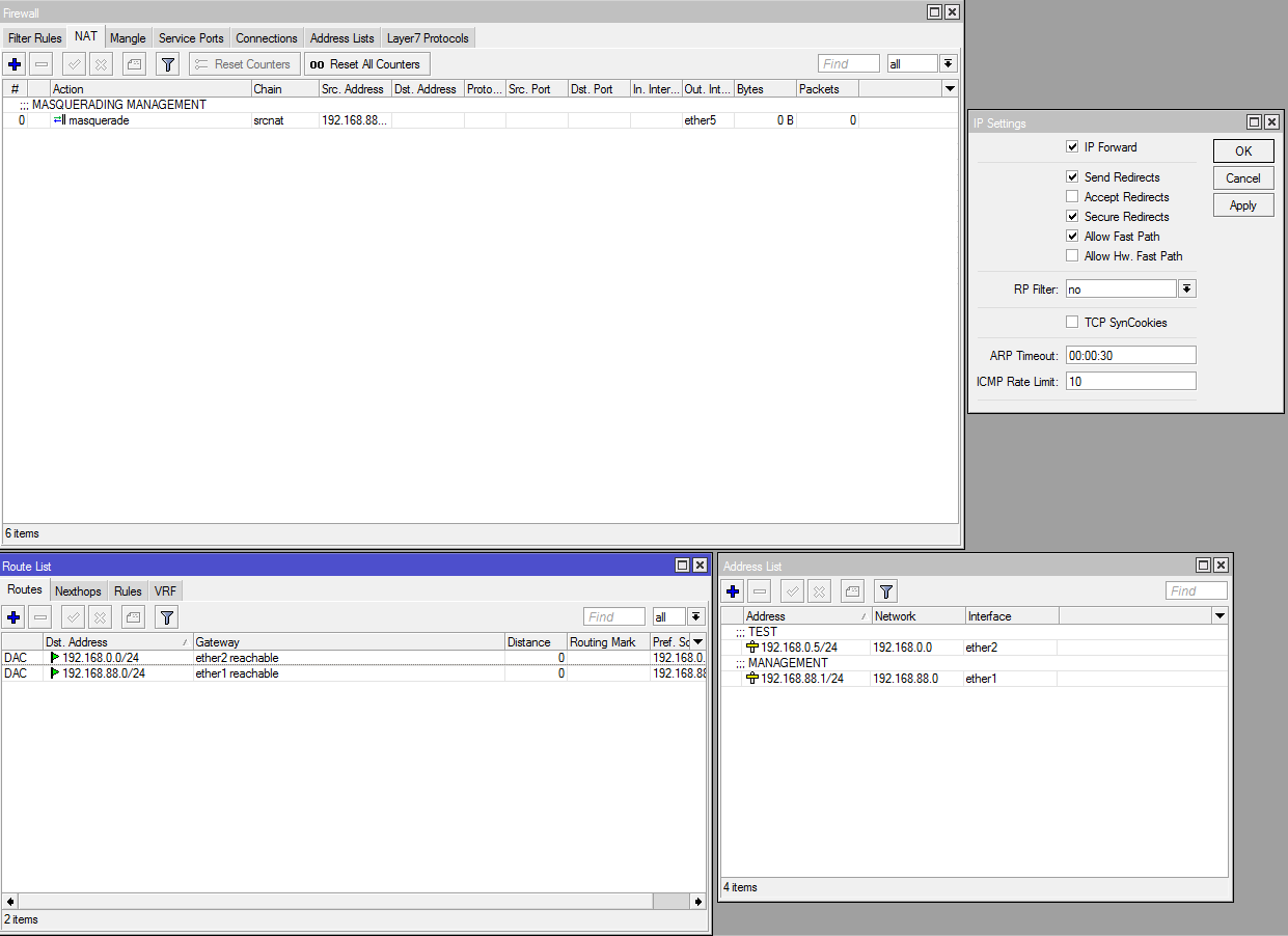

The forwarding is on and this is the situation.

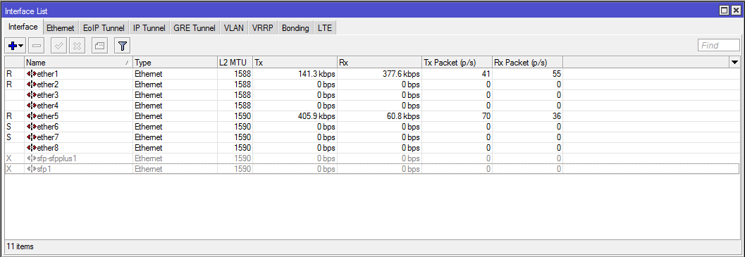

Can we get a screen shot of your interfaces as well?
Here it is.

I setup my CCR1009 with one subnet on port 1 and another subnet on port 3. Made sure neither port was a slave to the other. Communication between worked just fine.
I do find it interesting that you have some non switch ports with the Slave flag set. Maybe you should backup your relevant config, reset the config reboot/power it off, then restore the config see if that fixes it.
