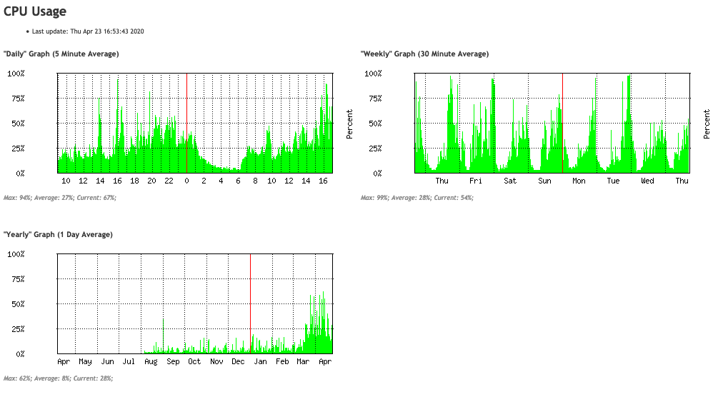

We have a CCR1009 which has 192 VLANS (one for each apartment) with packet marking & queues to speed limit each VLAN/apartment to their particular subscribed tariff. Throughput is less than 200Mbps.
This has been running fine for over a year but as the building is reaching 70%+ occupancy, we’re starting to see high CPU loads reach towards 100% (screenshot attached).
The obvious next step is to upgrade to a 1016 or 1032 but im wondering what headroom that will give me.
Perhaps it may be better to look for a different (less CPU intensive) method of limiting the VLANS?

It appears to be the firewall which is consuming the CPU. I suspect the mark connection is increasing the load?

Turns out we were marking every packet and not just new packets. This caused the high cpu load. Now the cpu is sat nicely at 15% :slight_smile:
