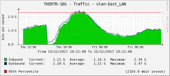

Some data collected last night. Note that a tweak in the client access network has allowed us to squeeze a bit more performance out of it (around 2.8gbps max) but there is definitely a ‘flat top’ to the graph which suggests to me that something is being pushed to it’s limit somewhere in the network.
I’m not sure either… I don’t know what is the limiting factor, I never drive the CCR’s to saturation because my internet links are too slow for that.
45% load is a figure I have never seen on a CCR I run… but with NAT my guess would be that the limit would be a mix between the amount of traffic and the number of new sessions per second, so there would not be a fixed capacity cap in Gbps.
Maybe there are others who have experience with a setup like that.
Edit: you made a post while I typed that and the capacity cap is not as flat as I guessed.
