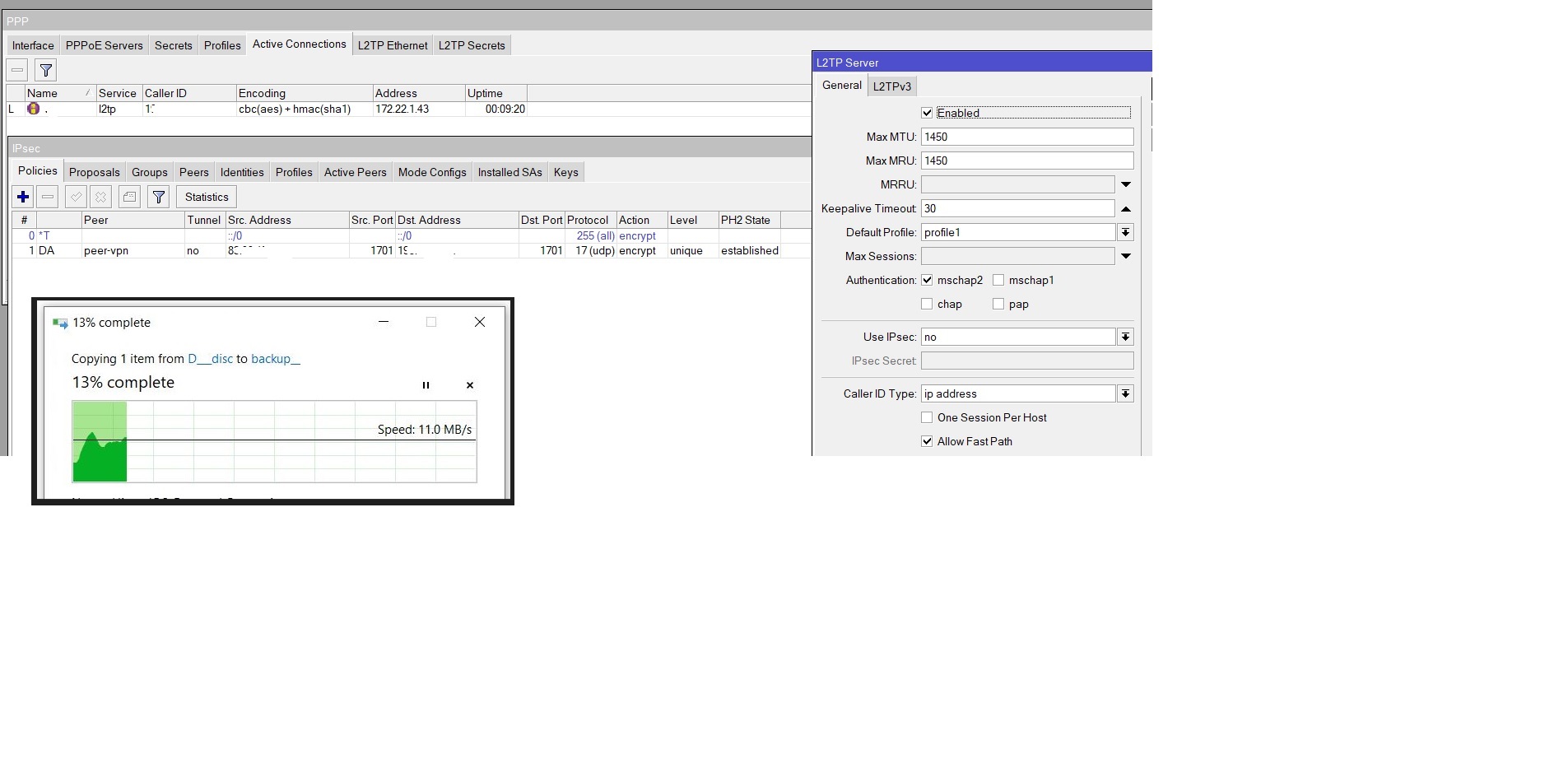

I have a problem with ipSec +l2tp vpn speed, mikrotik CCR1009(vers. 7.11, road warrior connection). After upgrading to version 7.x, iPsec L2tp remained slow. There were no such problems with the 6.x versions.
In the office, the connection is 1gb/s, but at home 600Mbps. L2tp ipsec data transmission speed is not higher than 10-12Mbit/s. Download/upload without using L2tp ipsec vpn works fine at full line speed.

If I switch to office->Home, then there is a problem because l2tp+ipsec speed should be at least 55 Mbit/s with a line speed of 600 Mbit/s. Mikrotik was reset a while ago. That didn’t help either. I tried to close with him from other resources, the result is the same. The motherboard does not show “bad block”. Maybe the problem is the hardware accelerator? But then the connection speed would be very slow.

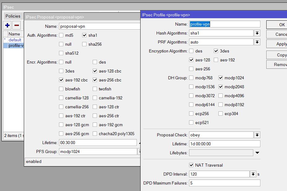

add action=accept chain=input comment=L2TP connection-state=new dst-port=\
    500,1701,4500 protocol=udp
add action=accept chain=input comment="IKE IPSec" protocol=ipsec-esp
    in-interface-list=!LAN
    ipsec-policy=in,ipsec
    ipsec-policy=out,ipsec
