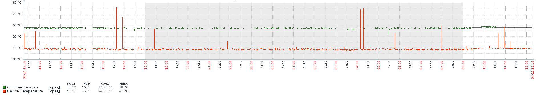

First i bought ccr1009PC and everything was fine with temp log. Then i moved to 1009+PC and temp checking script from time to time alarms about high temp but in health status everything was normal (i had a little script to check temp and sends email if it is getting too hot).
After months of sporadically false alarms i stoped the script.
Model: CCR1009-7G-1C-1S+
S/n: 914F0A7AC1B0
some data collected from device:

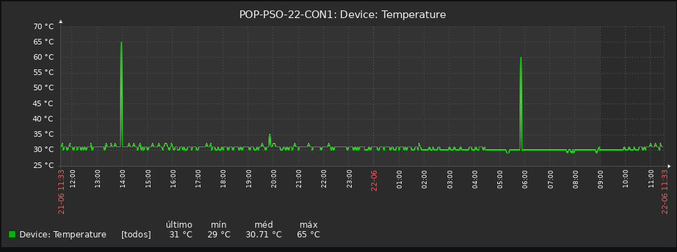

We are also experiencing the same issue with CCR1009-7G-1C-1S+ S/N 94C10A2586B8
Looks like S+ version have this issue with device temp, because Processor Temp is OK, I have 2 of them:
  1. CCR1009-7G-1C - Never seen this.
  2. CCR1009-7G-1C-1S+

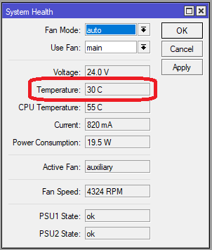

This is not shown only in SNMP data, but also in Winbox - System - Health, when you look at counters long enough.
You’re right. I watched for about an hour, my jumps were up to 108 degrees Celsius.

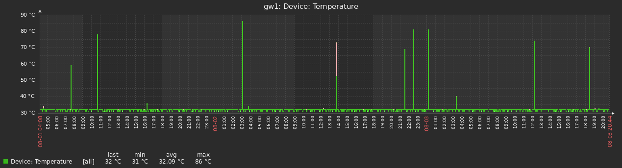

Hate to drag up an old post, but I’m seeing this on various CCR1036s and CCR1072s as well.
Various RouterOS versions (all “long-term” branch):
6.45.8
6.45.9
6.45.3
6.46.8
6.47.9 (this one is a CCR1009-7G-1C-1S+)
6.44.6 (I know that one is old and possibly insecure, not my position to update it unfortunately)
So it isn’t limited to CCR1009s… I’m polling with LibreNMS at 300sec (5 min) intervals.
