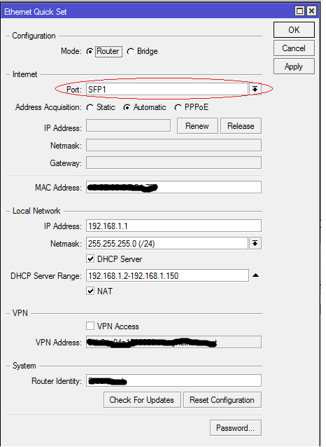

When I setup my internet Connection under Quick Set
Mode: Router
Address Acquisition: doesn’t matter what i select.
Port: eth1,
but when I select eth1 and press Apply it change it to SFP1
I tried to reset config and tried to restore config, but nothing sems to work.
I tried via console (serial), after I type in eth1 in Setup, it changed to SFP1.

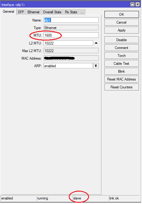

Maybe incorrect value for mtu or l2mtu?
Did you try 6.35.1 as well?
I will check if the mtu or l2mtu value changes between 3.64.3 and anything above.
Yes, tried 6.35.1 even tried 6.36rc10
Set mtu to 1500 in the old version, maybe l2mtu 1600 or so, then try the upgrade.
After the upgrade you can try jumbo settings again if you wish.
Don’t work. I can’t select eth1 it revert back to sfp1 when i press apply.
What I can se now that “status” for SFP1 is slave.
Can it be that I can’t use S-RJ01 for internet connection via copper-cable?

Well you did not do what I recommended. MTU 1500 L2 MTU 1600. Try it.
Sorry read it wrong.
Trying it now. :slight_smile:
Nope, don’t work.
