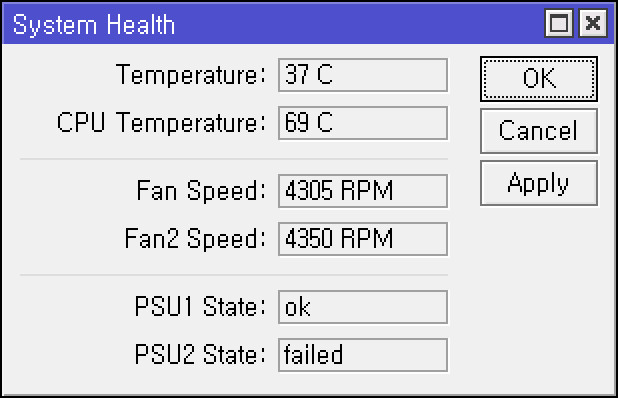

Is the temperature of the CPU high?
I use ccr1036-8g-2s+ R2 with hub rack.

No, not really. Mine is 47C at 23C input air temperature. Your input temperature is 37C (which is rather high), so my CPU would be at 61 degrees at that air temperature, assuming the rise is linear. It probably isn’t, so 69 degrees doesn’t surprise me. If it’s stable, I wouldn’t worry.
Air temp 37 degree??? Seems you have it a road POP… This core devices are designed for Data Room.
My router is in a closed rack that is soundproofed.
Thanks kindly answer
Better to have some ventilation!
Although cooler is better, these devices are tested up to 60 degrees Celsius ambient temperature. I’d say they can take 37C. A little fresh air wouldn’t be bad, tough.
If it is a gen1 (one 24v psu), most of the heat come from the psu, with the air trapped inside. On mine I just opened it, and lose like 10-15 degrees.
