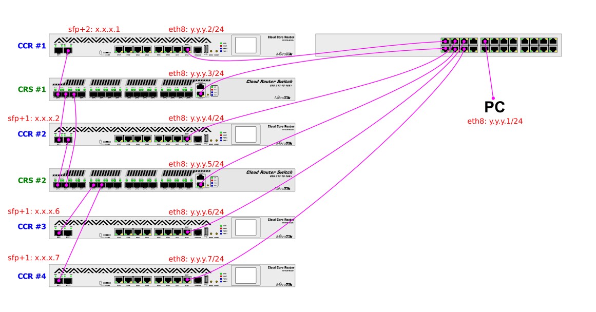

I’m going throught a dificult with one of our CCR1036-8G-2S+, where it regularly lose packets every 10 seconds.
In the diagram attached, the CCR #1 is the one with the problem. If I ping it, on any of it’s IPv4 address from any other CCR, it regularly fails for a fraction of a second, every 10 seconds. It happens both when I try to ping in the ethernet (eht8) interface (that is connected to our office internal network for management) and when I ping from any other CCR to it’s SFP+ interface addresses.
The CCR #1 is connected to the internet, and it does not only fails in the input chain, it fails regularly also forwarding packets.
I can verify it easy when I use the ping utility with a lower timeout like 100ms, and every 10 seconds (or 100 packets) one or two packets are lost. If I ping any address on internet that goes throught that CCR #1 it also fails the same way.

Are you sure no Loops are created (not physical ones)?
How have you achieved a Loop free topology ?
On the CCRs there are no bridges, and on the CRS #2 (where a loop might seem possible) the interfaces 3 and 2 have forward only to interface 1:

The thing is, the switch to the right, is an internal office switch, with our computers connected to it. If I open any CCR or CRS ssh/winbox and try to ping to any other CCR or CRS other than CCR #1, it works normal. The only one that is presenting regular packet loss every 10 seconds is the CCR #1.

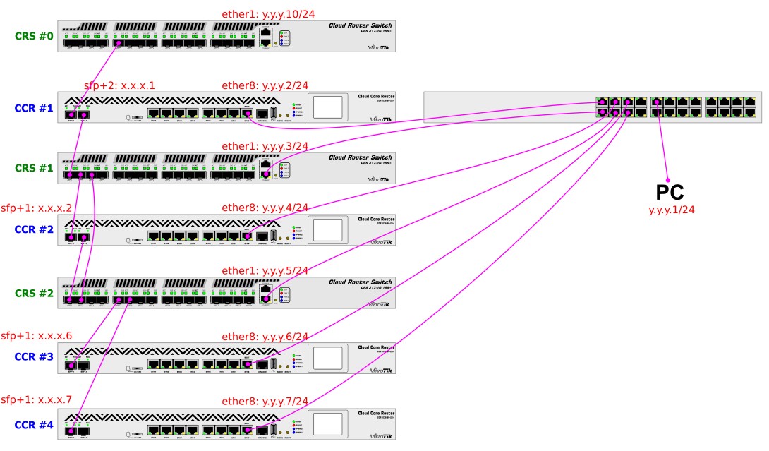

I actually have another CRS317 above that CCR #1, that is where I connect our services. And even from that CRS317 above (let’s say CRS #0) to the CCR #1 the loss still happens.
All management interfaces (ether8 on CCRs and ether1 on CRSs) have addresses, and when I ping the address of that interface on CCR #1 from any source, the same problem happens. There is no high CPU load, there is no high PPS (out of normal) on any interface.
The CCR #1 have peaks of 5Gbps maximum, but the problem happens even on low loads (like 2Gbps or less).
I have updated the diagram, and on CRS #0 I added a local address to the port connected to CCR #1, and the packet loss are still there.
