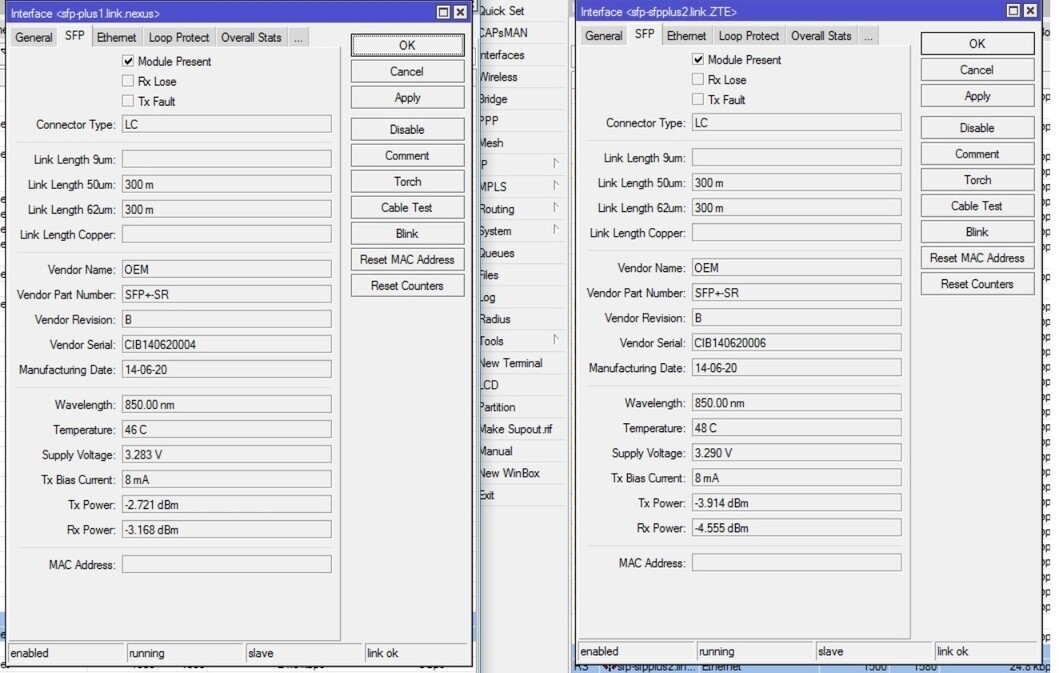

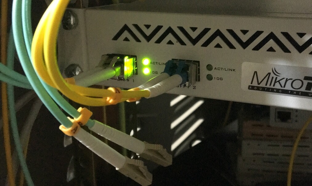

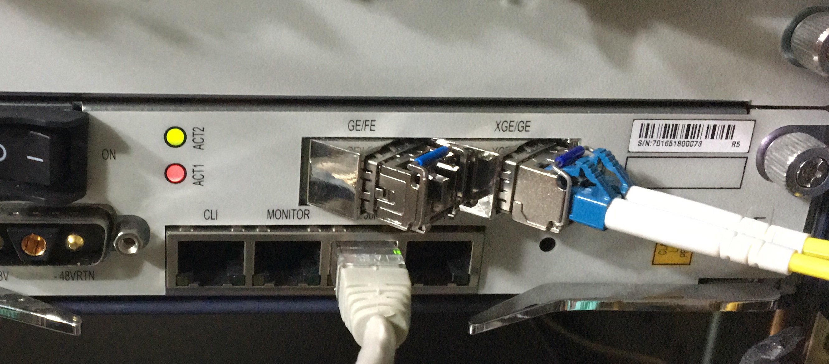

I have a CCR1036-8g-2S+ and I both 10G ports I have the same type and brand of SFP+, the same fiber patch but the traffic lights do not light for the second sfp+ even if the traffic lights are blinking on the opposite side (ZTE C320). I mentioned that the first FSP is connected on Cisco Nexus 3064. The sfp+ module is recognizing by RouterOS and the traffic it is ok, but the led for link connection/traffic is off.
Additionally, I made Router OS update at last one 6.39.2 with no result.
Any recommendation is welcome.

Both your interfaces is marked as slaves? Slave to what?
Post your configs and then we can perhaps see something.
They are both member ports of a software bridge.
It has the same behavior of lights-out when the sfp+2 port is out of bridge.
