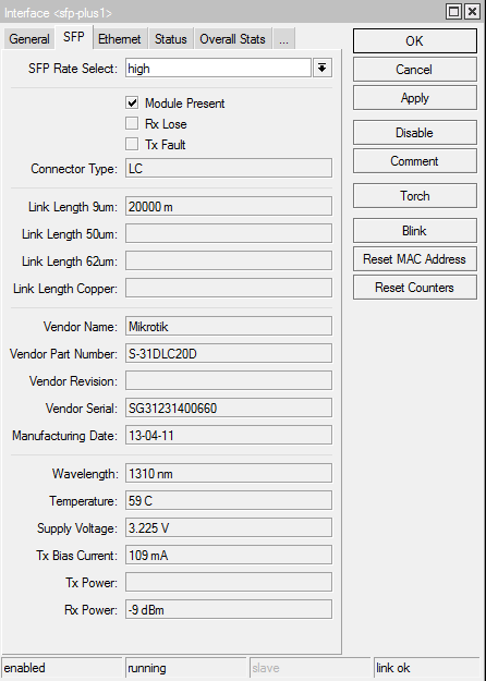

I hope someone can shed some light on this! I brought a CCR1036-8G-2S+ a few weeks ago expecting to use the SFP+ ports in the future. But since this we have had some other connections added in the datacentre which means the router needs a fiber connection to the remote peer.
So i went out and brought 2 x S-31DLC20D 1.25G Singlemode SFP modules.
one was to go in the existing CCR1036-12G-4S and other for the new router.
This is where to problem occurred the CCR1036-12G-4s worked 1st time no problems at all but the CCR1036-8G-2S+ would show link OK on the status but no link on the switch at the other end of the fibre it also shows tx Power as blank and rx power at -9dBm.
But as soon as you put this module in the other router it works straight away so its not the module or the fiber. I have also tried locking the speed at 1G full duplex it seams to make no odds and we also got the peer the other end to lock the speed still nothing.
I have also send a supout to mikrotik with some really useless reply’s “try disabling and enabling the port”
Just trying to figure if anyone else may have had any similar problems.

have you tested with SFP Rate Select = low?
I can confirm locking both ends makes no difference! The strange thing is even if you lock it at say 100mbits full duplex it still shows the link running at that speed! which im sure is not correct!
