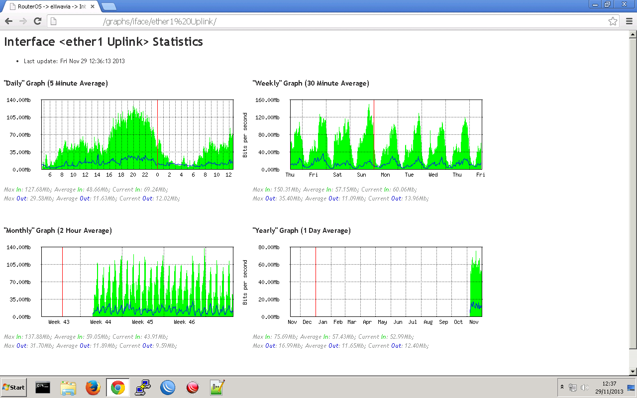

We’re having an issue with regard to the upload speed across our network.
Download is no problem at all that is ticking over nicely.
Currently we have ether1 as our uplink to the fibre network with a 300/300 circuit.
When we test via a direct cable connection we get about 260/270 up and down.
HOWEVER, when the client end uses the connection the upload is significantly lower, the image that’s attached shows that the usage never goes much above 35Mbps.
Just need to know if this is a hardware issue with regard to port one, or a config problem with regard to the PPPoE connections and the queues being used.
Just need to eliminate all possibilities.
try to switch the port on router. I have not have tis issue on a CCR, but on 1200 etc this has been an issue.
Also : How do you test the result? what its speed from CPE to router?
