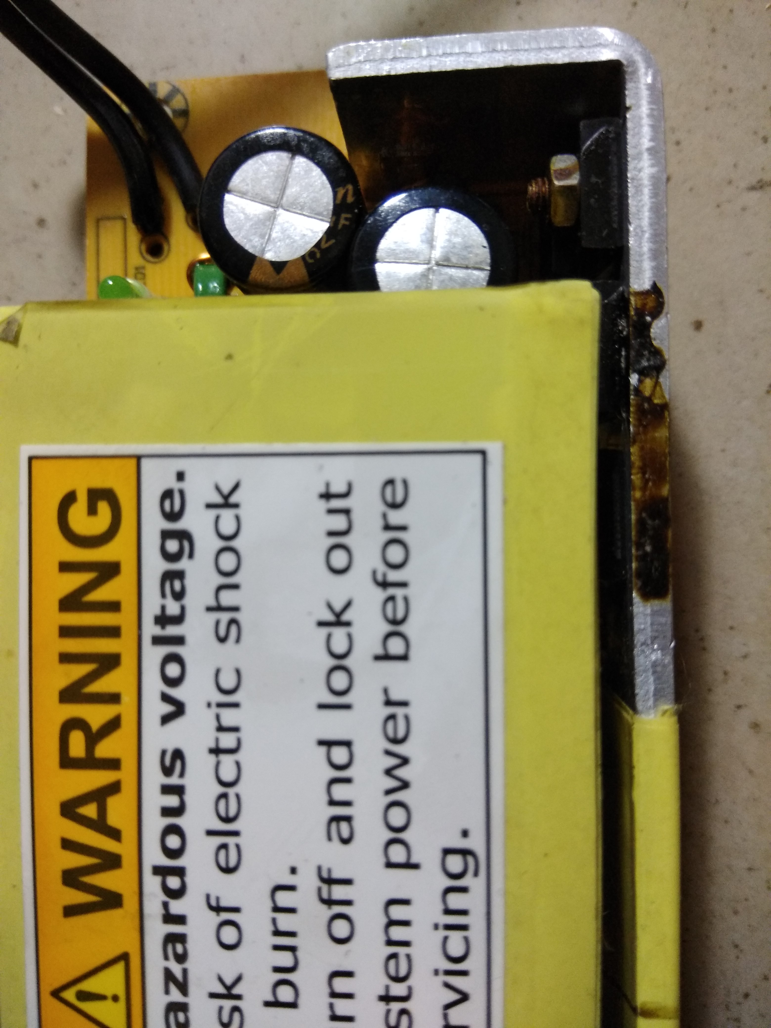

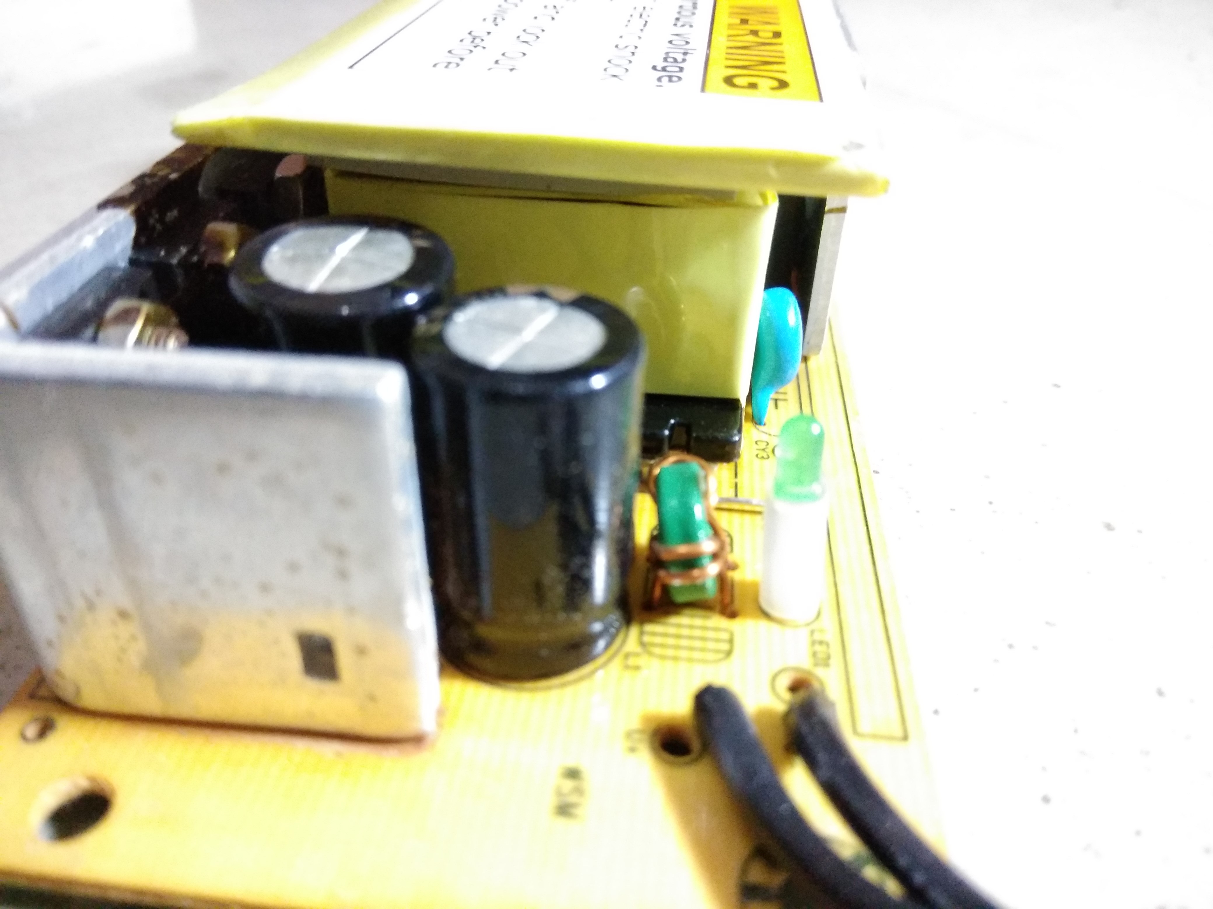

Hi All
The current PSU condition is like this
If I replace with another brand with 24v 2.5a power can work well.?
Because I have trouble finding the capacitor.
Thanks,
![IMG_20180506_103526[1].jpg](https://data-discourse.cdn.mikrotik.com/original/3X/3/0/30274ac28e0fb139d0f9d4852e16b51d415c59fc.jpeg)
![IMG_20180506_103410[1].jpg](https://data-discourse.cdn.mikrotik.com/original/3X/5/a/5afbfb56ec95f82ad9f38683493a193ed6a73750.jpeg)
Capacitors are the two black cylindric elements with metal-exposed tops. The one farther from wires (right one on first attached photo) looks suspiciously bloated. If you can find somebody with soldering skills, have both of them replaced with new ones of same capacity.
Hi Mr mkx.
Thanks.
SOLVED

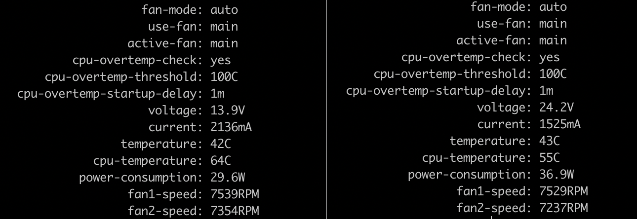

Just had one of our CCR1036-12G-4S start rebooting and having trouble starting up. It’s a number of years old and it’s the first issue we have seen. We had a standby CCR1036-12G-4S just in case.
Now without a load it seems to be running so I’m able to compare the voltage that is shown by each router. Perhaps this is a way one can detect a failing unit if the voltage is dropping.
Notice the bad router on the left has a voltage of 13.9V compared to the good router on the right of 24.2V
If I just replace the power supply will the bad router be back to 100%? Could the failing power supply have damaged the router board?
It will be fine when you repair or replace the power supply.
(just the electrolytic caps need to be replaced)
