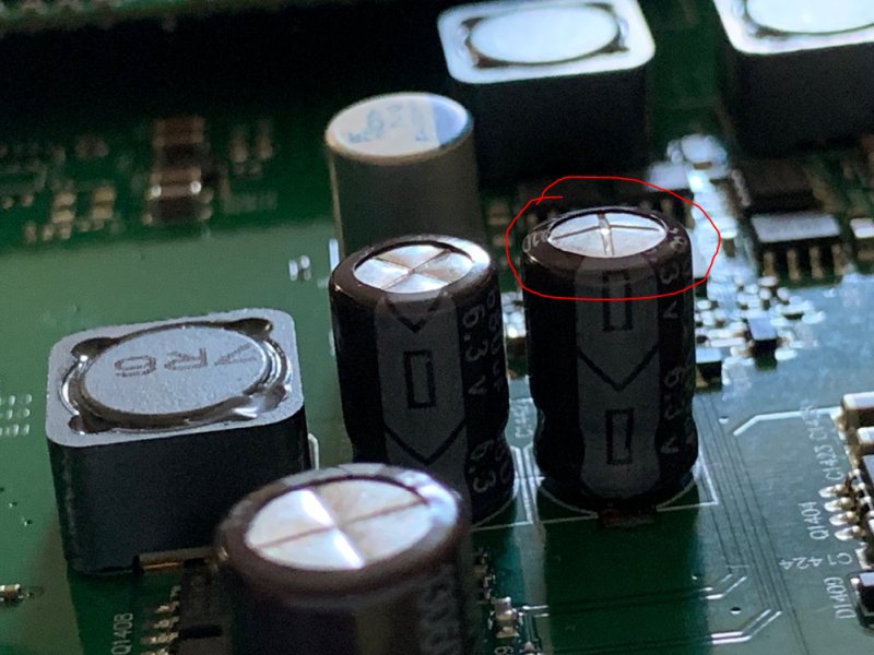

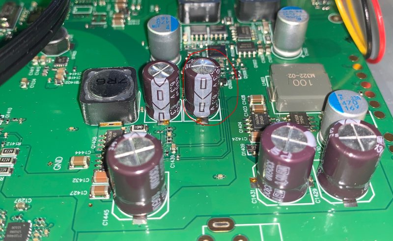

Inspection of the motherboard showed that the capacitors C1442 and C1443 were slightly swollen. Okay nothing to lose, we tried to change them.
We soldered new ones with higher quality.
When testing the router, everything turned out to work properly.

6 months ago we experienced exactly the same thing. CCR began to reboot and persisted even after the power supply was replaced. Optically, we saw that the capacitors C1442 and C1443 are inflated, so we had them replaced with new and better ones. Since then, everything is without problems.
Today, we preventively replaced another CCR in the data center. When we opened it, capacitor C1442 is inflated again, but it still works. As a precaution, we have the C1442 and C1443 replaced again with new and better ones.

Got a CCR1009 here with these symptoms (temperature reboot, though unit is cold). Replaced bulged caps C1442 and C1443 (680µF/10V) with Panasonic FR and it worked again. System Health showed voltage around 22V. This seemed a bit low.
Therefore I checked the (external) 24V/2.5A power supply and found that output had a 60kHz ripple with about 2V peak-to-peak and voltage drops significantly under load. Inside were two bulged caps 470µF/35V. Replaced them with Panasonic FC (didn’t have FR at hand) and also replaced a good looking “low ESR” 100µF/63V, which turned out to have high ESR.
Looks like the power supply caps gave up first and then the high ripple eventually killed the caps inside the router. Lesson learned: Watch the voltage display and if it drops below 24V, replace the power supply before it causes further damage. Replacing the caps inside the router was no fun. You have to remove the CPU heatsink (heat pipe) and soldering this multilayer PCB requires a LOT of power.

I just revive my CCR1036 by replacing PSU C10 faulty capacitor, thanks for this post, i had a look on C1442 / C1443, both of them have the metal top bulge up, i will replace them as well, hope i don’t need to open it up every 1-2 years. Very much appreciated the information.
I just replaced C1442 / C1443 with a little bit higher capacitance and voltage rating capacitors. 16V / 1000uf to the original 6.3V / 680uf.
All works great. The health voltage rises up from 22-23 Volt to stable 23.8 Volt.
