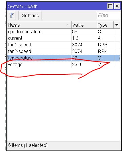

Nice, after one year all CCR1036 PSU dies? I found not just PSU, please also check System → Health → Voltage
Just replaced C10 capacitor on PSU, and C1442 / C1443 capacitors on main board.
If you only replace C10 capacitor on PSU, the main board may drag it to burnout again, you can notice the voltage jumping around 22-23,
sometimes even lower than 22. Not until you replace C1442 / C1443 together then the voltage rise up to the normal 23.8-23.9 Volt.
