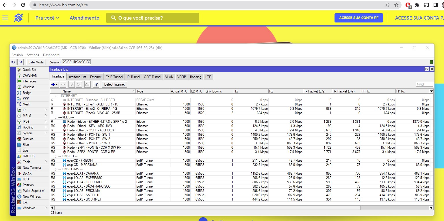

FOLLOW CONFIGURATION IMAGE

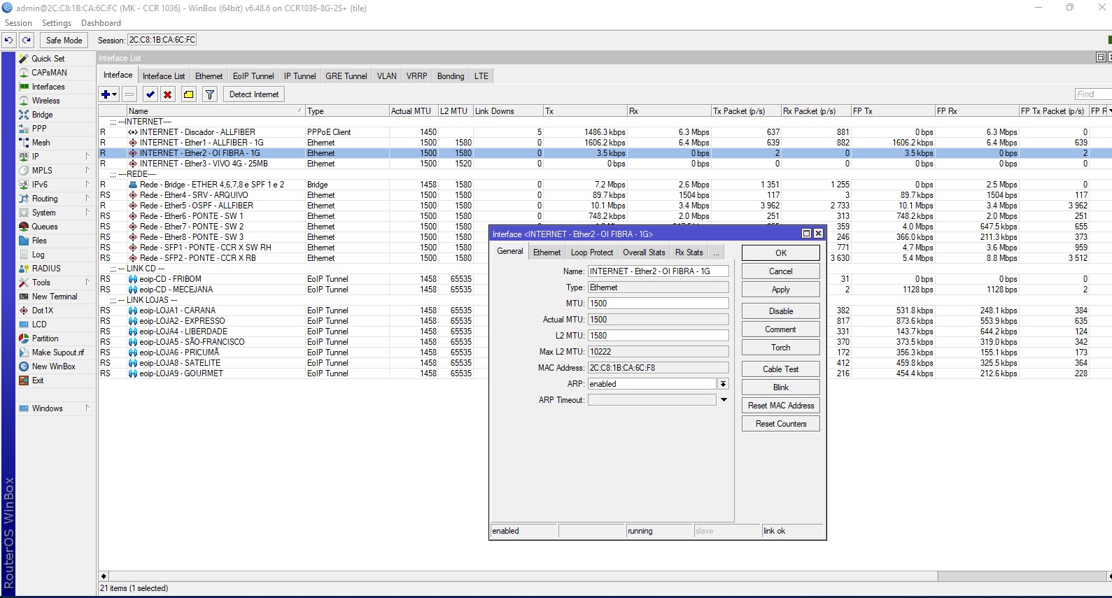

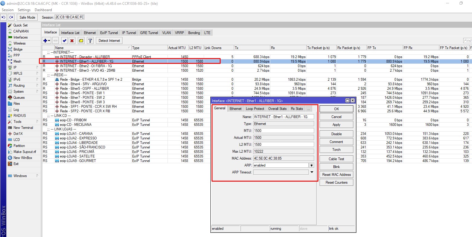

first image is from internet link 1, and link 2 and that is having problems.
Bridge has 1458 as MTU. It is because eoip tunnels that are members of the same bridge.
Change MTU of EOIP tunnels to 1500 and make sure Bridge actual MTU changes to 1500 also.
