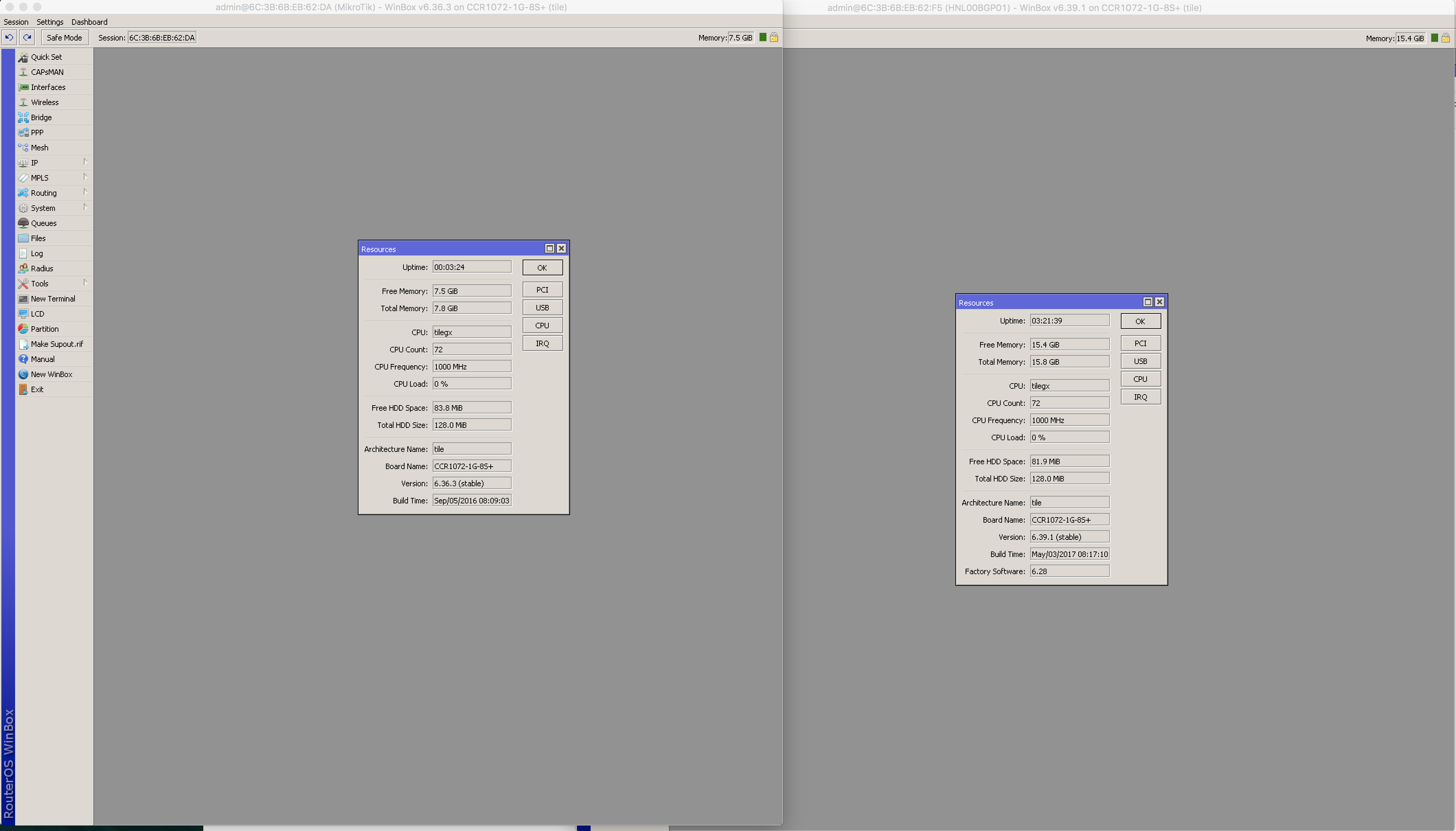

I recently purchased 2 CCR1072 from my vendor. Both that I recieved only showed 8 Gig of memory instead of the advertised 16 Gig.
My vendor did RMA both Routers. the first replacement i received showed the advertised 16 Gig of memory however the 2nd one i received just today only shows 8 Gig of memory.
What is going on with the Hardware. 3 our of 4 tells me that something in very awry in the manufacturing process with mikrotik. I have also opened a support ticket with Mikrotik on this last Friday with absolutely NO response from them at all. here is a picture of the side by side of my two CCR1072.
Has anyone else had this problem and is it possible that Mikrotik has a bad run of 1072’s. Some answers would be appreciated especially from Miktorik as this is their Flag ship router and right now they are at a 75% failure rate.

FYI. a little more information I did reset the router via WinBox and a hard reset. Still the same limit of 8 Gig of Memory.

As an update, Mikrotik has completely failed with this. I have received 5 different Routers of all 5 only 1 shows the correct memory. 3 showed only 8 Gig and 1 showed 12. From my position that is an 80% Failure Rate. I have not received any help from Mikrotik on this and they just refer me back to my vendor. Who by the way is fantastic.
also Understand that I know that 8 gig or 12 gig is sufficient for what i am doing with these routers. However, the improper memory on the system, and the guarantee from Mikrotik that it was built with 16 GiG of memory shows inherent component failure on the device. Therefore it is reasonable to assume that the remaining component in the router can fail at any given moment. Thereby making the system untrustworthy in any core network.

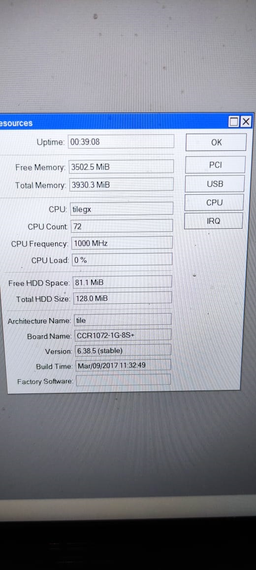

4 GB for me.

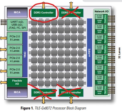

Is it possible to replace the processor / memory modules (soldered to the board) at a service center without losing the license? Or are you already throwing this equipment into the trash?
If I understand correctly, either 3 out of 4 memory chips or controllers in the processor could fail here. But RB started corretly.
