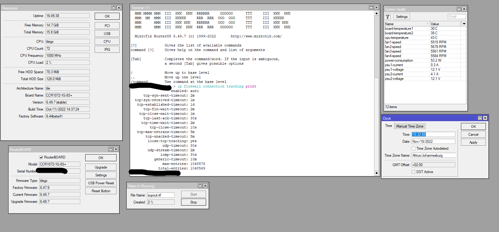

The router reached max-entries again this afternoon, and this time I tried to Make a Supout.rif. Unfortunately the Supout.rif just gets stuck at 2% does not complete. I then proceeded to reboot the router and now it does not come back at all, I suspect the Supout.rif that was in progress is keep the router from rebooting.
We will have to power cycle it.
See attached for screenshot with info before reboot.
I have reported this as a bug with Mikrotik, lets see what they say
