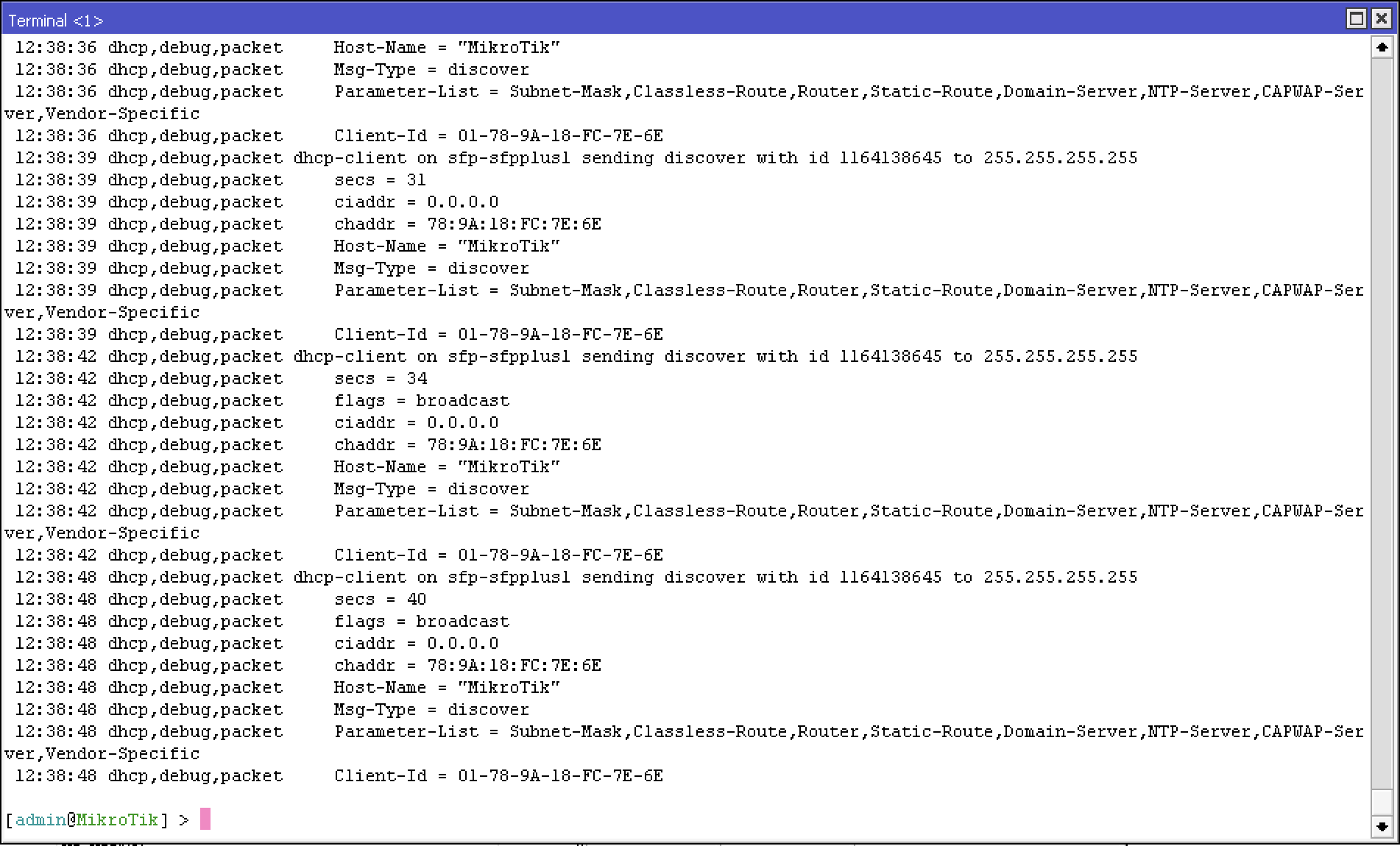

I see dhcp sends dicover request but it does not receives offer request.
I am not able to find any differences in the setup.

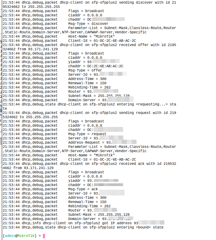

Here is log for dhcp client from CCR2004-16g-2S+:
And on CRS326-24G-2S+:

Here are logs from terminal:

Dhcp client logs:
15:41:57 dhcp,debug,packet     Client-Id = 01-78-9A-18-FC-7E-6E
15:42:04 dhcp,debug,packet dhcp-client on bridge1 sending discover with id 3455712930 to 255.255.255.255
15:42:04 dhcp,debug,packet     secs = 35
15:42:04 dhcp,debug,packet     flags = broadcast
15:42:04 dhcp,debug,packet     ciaddr = 0.0.0.0
15:42:04 dhcp,debug,packet     chaddr = 78:XXXXXXXXX
15:42:04 dhcp,debug,packet     Host-Name = "MikroTik"
15:42:04 dhcp,debug,packet     Msg-Type = discover
15:42:04 dhcp,debug,packet     Parameter-List = Subnet-Mask,Classless-Route,Router,Static-Route,Domain-Server,NTP-Server,CAPWAP-Ser
ver,Vendor-Specific
15:42:04 dhcp,debug,packet     Client-Id = 01-78-9A-18-FC-7E-6E

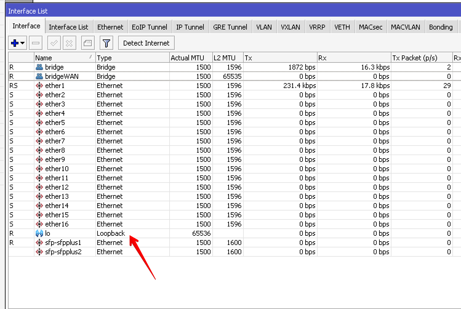

I see loopback interface on CCR, could that have any impact on my issue?
Nevermind, I was commenting on a temporary setup, later corrected.
