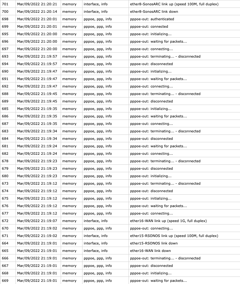

I don’t see anything in the logs around that time other than what is in the attached image. But what I believe happens is the pppoe connection goes down first, then the WAN’s physical interface goes down (16 in the attached image). Then the 100mb interfaces on the same device will flap. I think that the interfaces being 100mbit is related to them flapping for some reason. The other gigabit interfaces don’t flap when this happens (other than the first offender - the WAN), and the 10gig interface going into my root bridge/10gig core doesn’t flap.

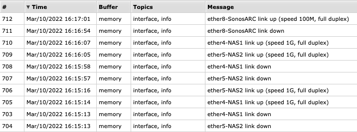

A 100mbit interface on the CCR2004 flapped again. This time it was when I rebooted a synology that’s hanging off of the device with 2 gigabit interfaces. This synology device is not generating spanning tree events like the sonos products do, so I don’t think this is spanning tree. I tend to think it’s a bug. But I’m certainly open to being proven wrong.
It seems to me that when an interface on the device’s gigabit ports changes link state, the interfaces that are 100mbit (in my case) can flap. They are set to auto negotiate right now, so I’m going to hard-code them at 100mbit as a test.
