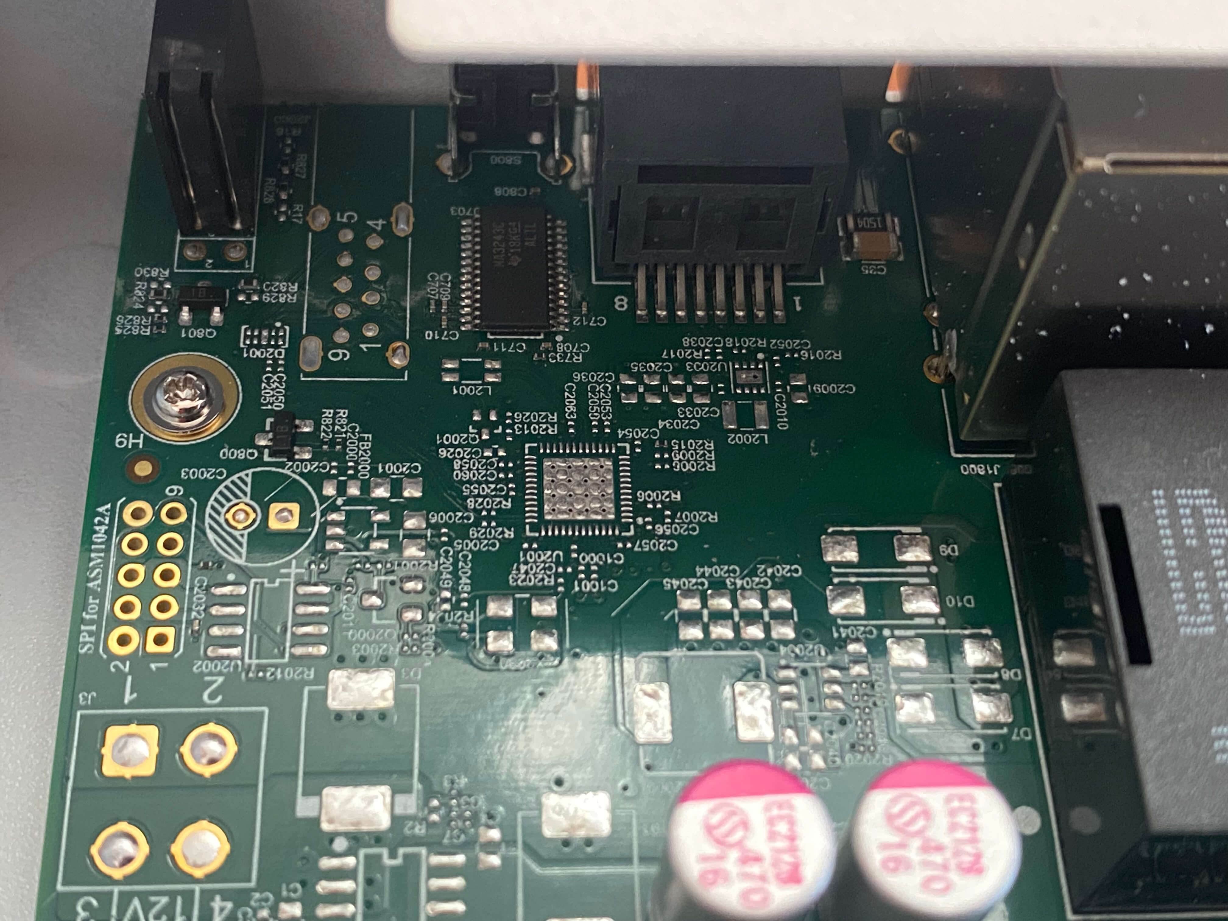

I just want to share my frustration with the CCR2004-16G-2S+PC. I was super excited about it when I first saw it on the YouTube channel and now I have one. Currently I have a RB5009 running some containers and working as main home router, but I would like to have a second SPF+ just to connect another switch with a 10G uplink so I bought this CCR2004. I just was half way of replacing the RB5009 with this new, awesome and powerfull router when I realized that it only had 128MB of storage and absolutely NO usb ports to add some memory for the containers. I removed the top cover to check if there is any slot for an SD card, but no, nothing. All I saw is a place on the motherboard where the USB port should be, and there is enough space to fit it! The question is WHY? Why did you removed the USB port and took all this beautiful container features???

I haven’t opened it, but maybe there is USB header inside? Or unpopulated USB connector? I can’t find high res image of the PCB anywhere.
Well, as I said, there is a usb header inside waiting to be soldered, but there is a chip missing. The trace from USB go to a pad where some chip should be placed. There is another header for ASM1042A, which is a USB to PCIe3.0. This is really frustrating.
Here is a pic of this part of the board
Can’t see all PCB traces on the photo, but it looks like all traces from ext connector go to the ASM1042A. The L2001 are just interference reduction chokes and D2001 are ESR protection diodes. U2002 is clearly SPI flash for ASM configuration. Area around U2003 is DC-DC switching converter (probably just for USB 5V supply).
But all traces are going to ASM, there are none going to the CPU itself (unless there is another connector/header somewhere for that).
Soldering all these SMDs is probably not an option (too many of them, even if most are probably following reference schematic).

Still would be interesting hack. I thought about it some more and cleanest way would be to make mod board that on one side fits the ASM pinout (with small pads with golden plated castellated edges for needed pins, so they can be soldered nicely) and then is longer on the opposite side with micro-usb-3.0 connector on it to connect mining riser with regular USB 3.0 micro to type-A cable. Could attach it on multiple spots to grounding points so it’s also mechanically stable (just like some high quality mod boards for gaming consoles etc..). And it’s easy to do length and impedance matching on the PCB unlike some questionable wire mess.

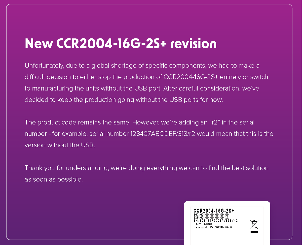

Actually the reason was CoVID: the IC could not be sourced any more and the design of the PCB could not be changed. (PCBs take long to get them maufactured, so they can´t be easily replaced to accomodate another IC.)
That was probably the reason according to what I read in the forums and what I hear from other vendors as well.
Well, yes, the board still the same, they do manufacture and sell the full ccr 2004, so wha is the reason to not solder the usb on that board? If they have components for the big board, then they should have enough for the small one as well
Just guessing, but I think they had a limited number of ICs, so they have decided to put those they had into the bigger box.
also retiring UBS deducts some watts from device power budget, another reason to opt on removing it, specially on a passive cooled device
