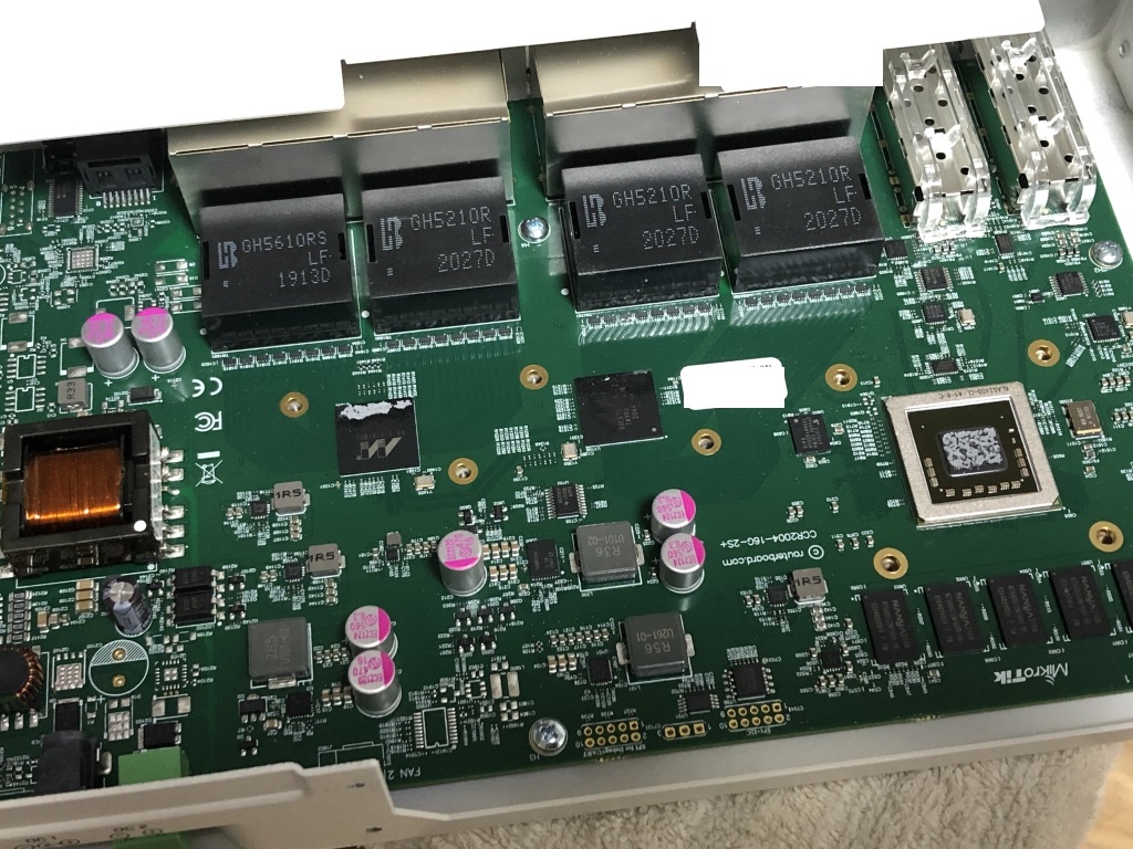

Please will uploading a captured image. - /system health print

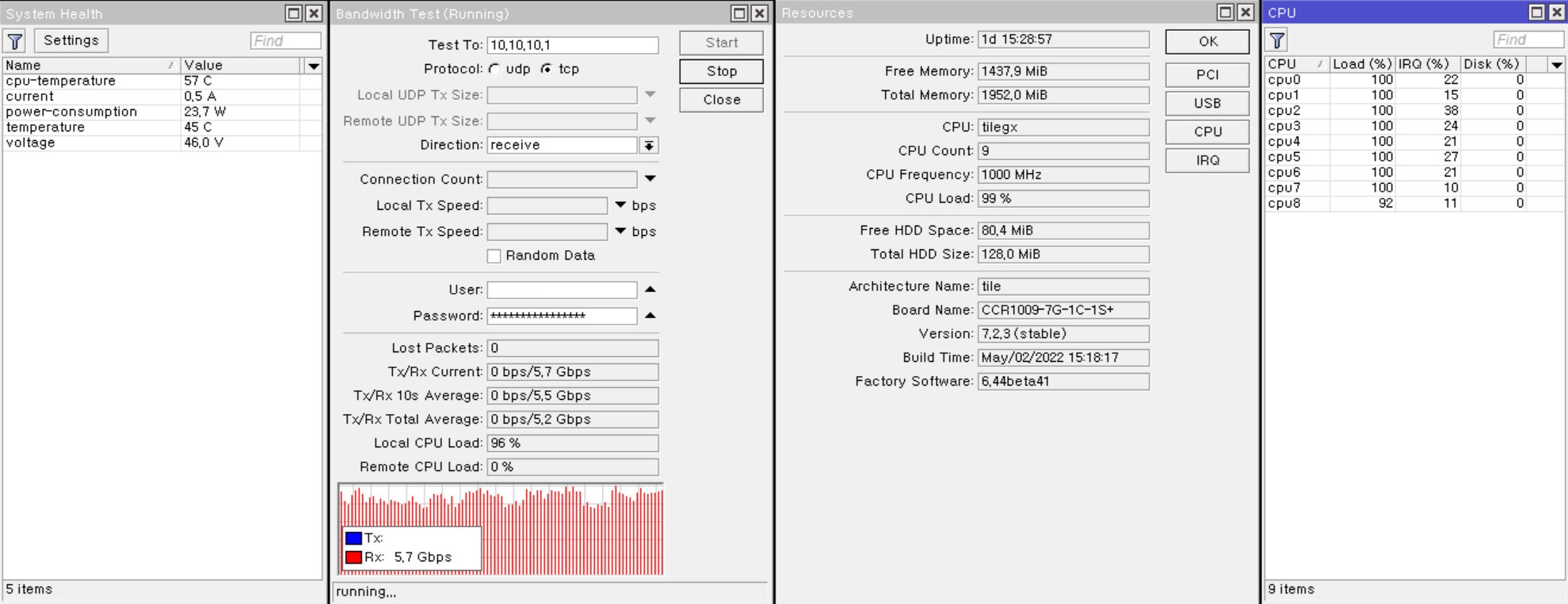

I have a CCR1009-7G-1C-1S+PC and 6 May purchased CCR2004-16G-2S+PC

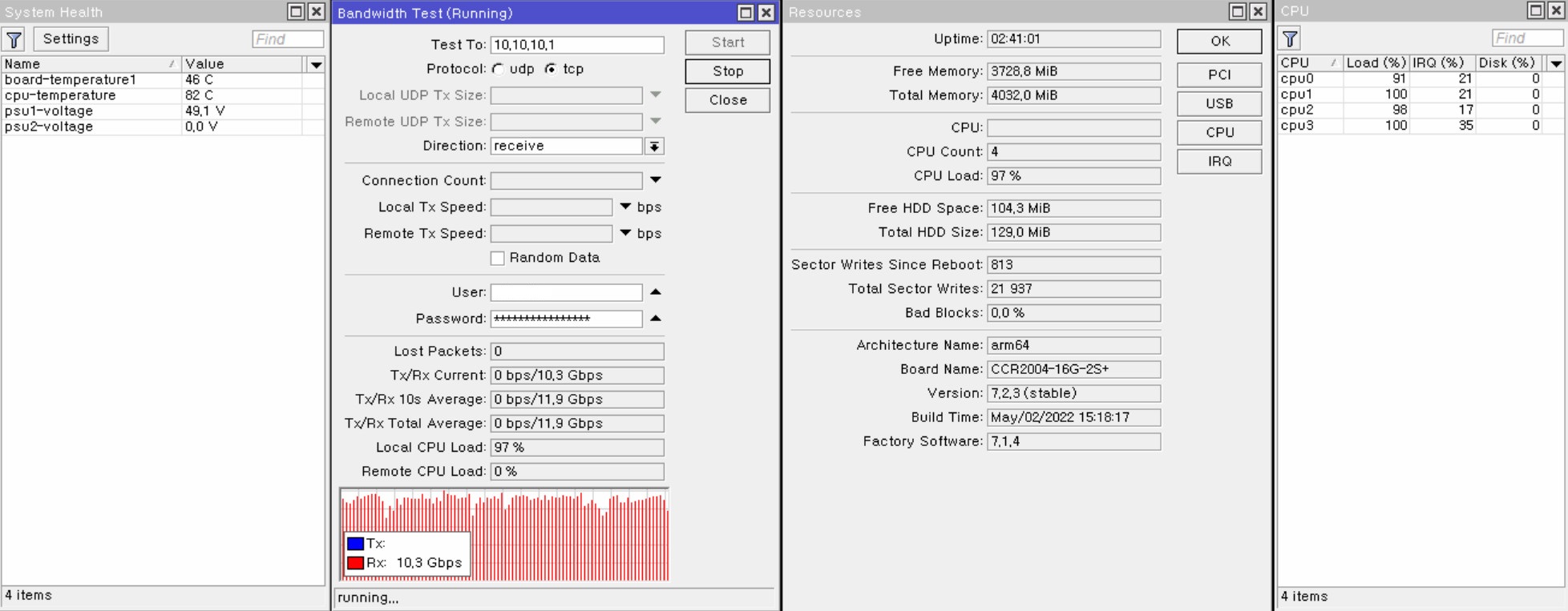

CCR1009 is about 57’C in full load but not more than heat CCR2004.

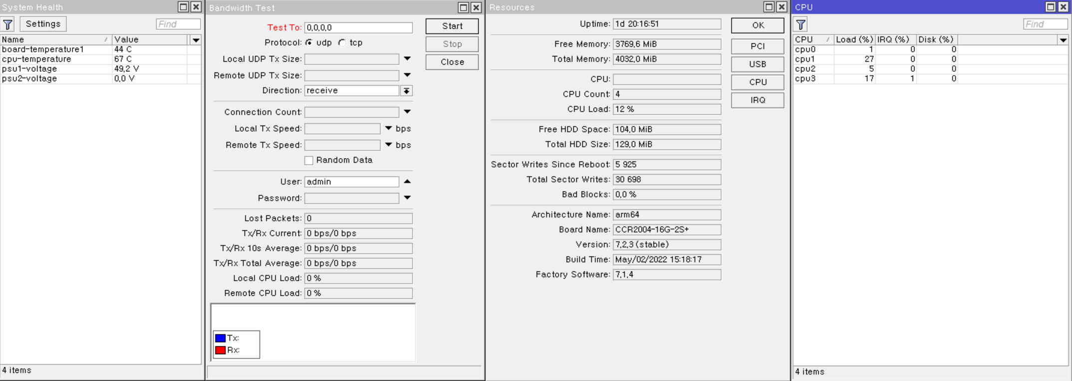

CCR2004 full load 82’C, Idle 67’C
Will there be any problems in use?
I think CCR2004’s CPU temperature is some high.

May it seems an assembly problem, such as a heatsink installation problem or a thermal grease problem?
(ex/ Heat sink and CPU is not stick close)

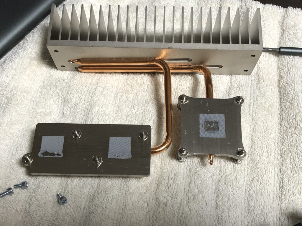

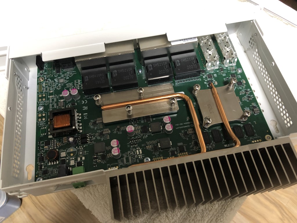

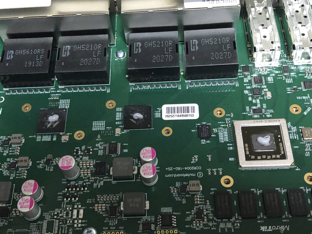

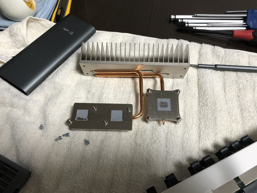

I am solved. The thermal grease was reapplied after MikroTik support.
The temperature is down max 10~20’C

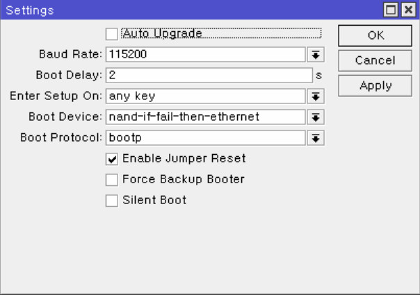

/system routerboard settings print
It's same.
auto-upgrade: no
baud-rate: 115200
boot-delay: 2s
enter-setup-on: any-key
boot-device: nand-if-fail-then-ethernet
boot-protocol: bootp
enable-jumper-reset: yes
force-backup-booter: no
silent-boot: no
protected-routerboot: disabled
reformat-hold-button: 20s
reformat-hold-button-max: 10m

We have had the same exact router model - and the CPU was overheating 103C at IDLE !!!
After reapplying thermal paste now the CPU is at 77C - a huge improvement.
We will replace paste with thermal pads for added efficiency.
It’s actually better to use a high quality thermal paste than pads. (Be it silver or ceramic based, would not recommend any of the liquid metal products for use in a router as there can possibly be issues with reactions with the metals)
Pads are normally used when there is a bit of a gap between the heat sink and the component to be cooled (often used on ram chips to help cool them as they don’t normally generate excessive heat). Pads also have a lower heat transfer ability.
The alternative to pads if you want there are thermal sheet products that are reusable, but I wouldn’t recommend them mostly for their cost, and a high quality paste is usually more effective.

You are probably right - currently we are using thermal pads and temps are 44board and 57Ccpu on idle - again a bigger improvement than 77C and 103C on idle
When I first exracted the heatsink, the thermal pad was not attached and the thermal paste was hardened.
I think, The thermal paste application seems to be correct and I used MX-4.
