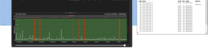

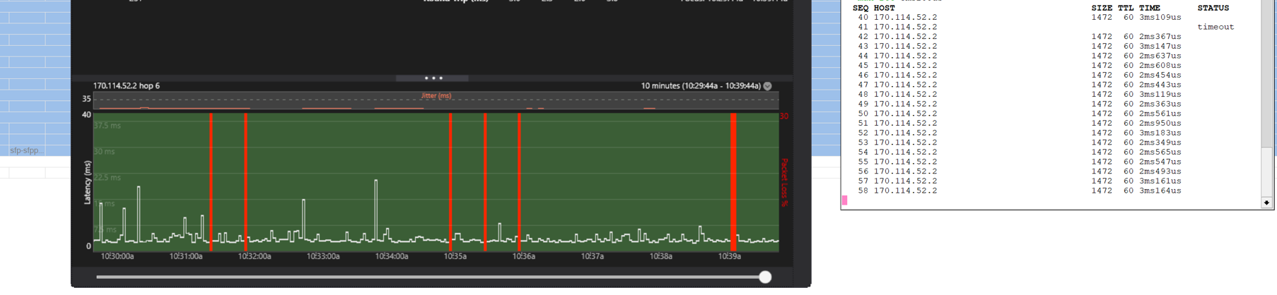

  • When this happens, I can see if I’m running a pingplotter from another machine to zoom that I’m getting packet loss at the same time with a lost ping packet. (I know pingplotter can be misleading, however using old router I see absolutely zero packet loss doing the same test from the same endpoint)
  • If I ping zoom from the CCR, I also see timeouts at the same time that this happens

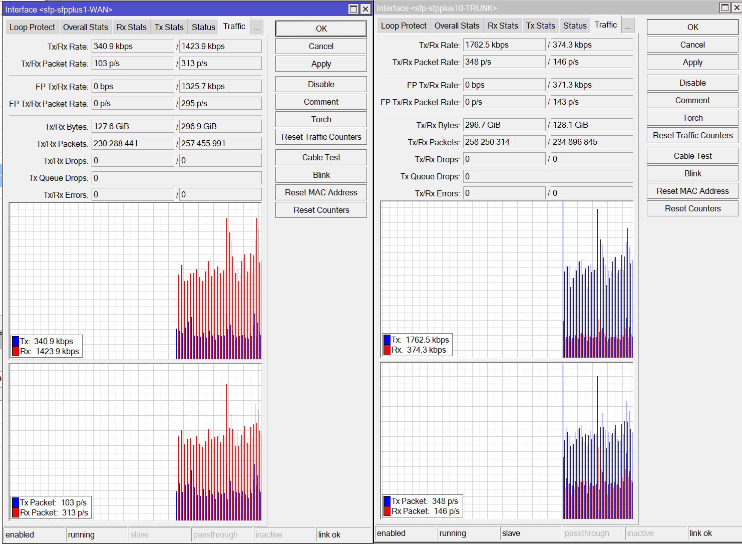

  • If I look at the queue traffic, as well as WAN/LAN interfaces, I also see it present there with gaps in the traffic graph, where it occurs across ALL interfaces (see attached screenshot for the blank line almost in middle) - note that this blank line in the graphs does not show as tx/rx drops or errors in either interface.
