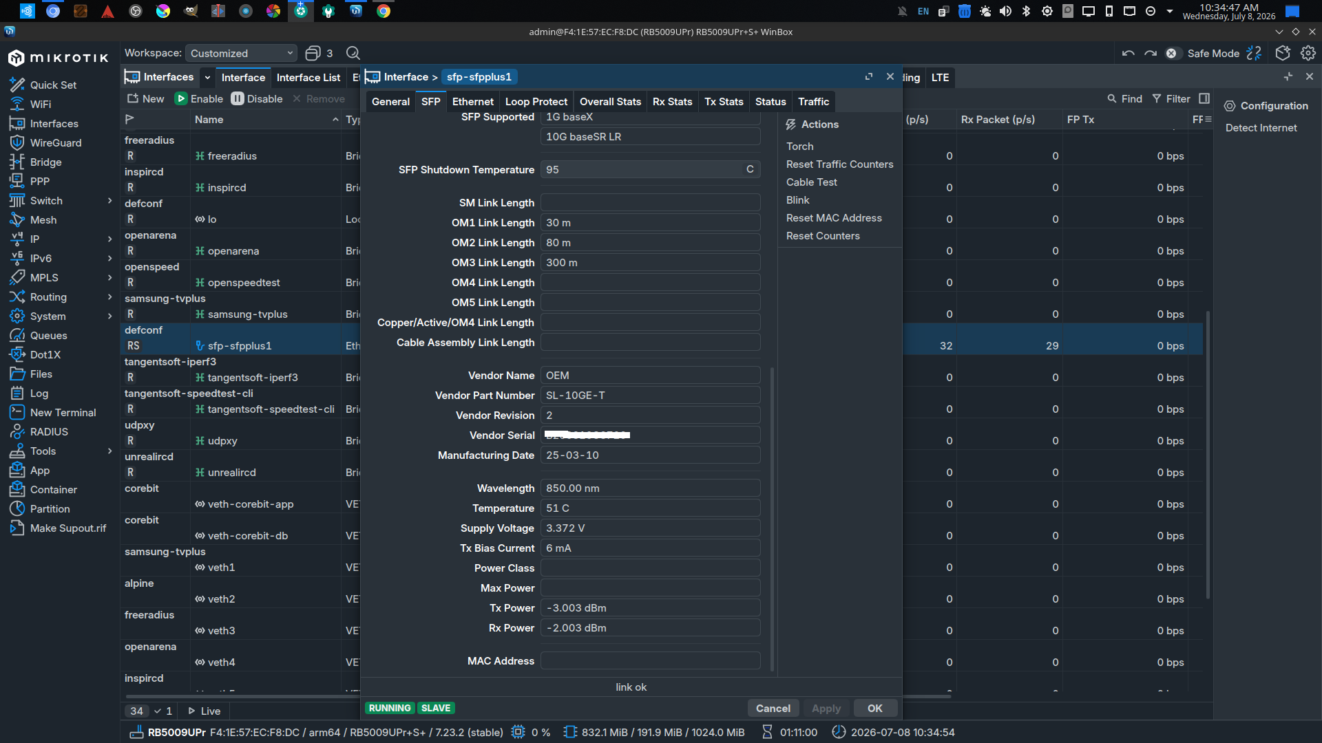

So far, I like this SFP module SODOLA SFP Module SL-10GET2
Temperature stays around 51 C - 53 C
See link below.
Amazon SODOLA SFP Module link

RB5009 at 10G
That's a huge improvement compared to the MikroTik S+RJ10.
Just to make sure - was the SODOLA module around **53°C in the same RB5009 where the MikroTik S+RJ10 was around 90-100°C?

Patch cable to SODOLA 10G switch.
