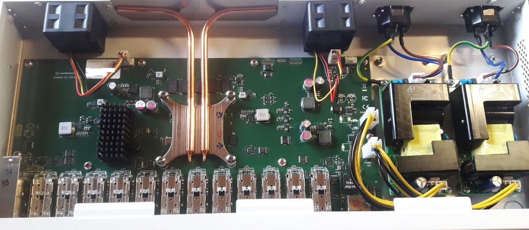

is known if you can use more than 4GB in the CCR2004-1G-12S+2XS ? For BGP, 4GB is not that much. Unfortunately I found a picture of the board itself on the net. My 2004er ordered is still on the way to me. Because you can surely use a DDR4 bar with 8GB?

According to MT, the 4GB memory in the V6.x cannot be expanded. If you look at the picture, it’s also clear why. The DDR4 RAM is not inserted :slight_smile:

Thanks for the picture. Yes the memory is indeed soldered in.
Isn’t it a bit strange to have both fans and passive radiator on the back?
I mean, either you have a fan or you don’t. Either you have it in a quiet place (like home/office), or you have it a noisy place (witch is more likely because of the high speed interfaces)

The heatpipe/radiator are for cooling the CPU. This is 100% passive, dependent on ambient convection. (should get quite toasty in cabinet environments, might force us to adapt some fans on the back).
the internal(infernal?) fans, are there to force airflow in the front–>back direction.
there needs to be some airflow arround the SFP modules, so i believe that the fans should activate in response to (the maximum? / an average?) temperature reported by the inserted modules, and completelly ignore the CPU. (maybe some input from the 25Gbit PHY).
Now, with that much space, i wonder why couldn’t mikrotik give us some blowfan-based cooling solution, so it doesn’t sound like the router is taking off.
I agree with guipoletto. The cooling solution is a bit odd.
Since both 25G and 10G SFP’s might get quite hot, running fans is probably mandatory.
But the running fans won’t be able to cool the switch ASIC since it has it’s fins/radiator on the back.
This category of device isn’t typically a devices that needs passive or silent cooling. No one will probably care.
CRS317-1G-16S+RM has alike structure inside.
