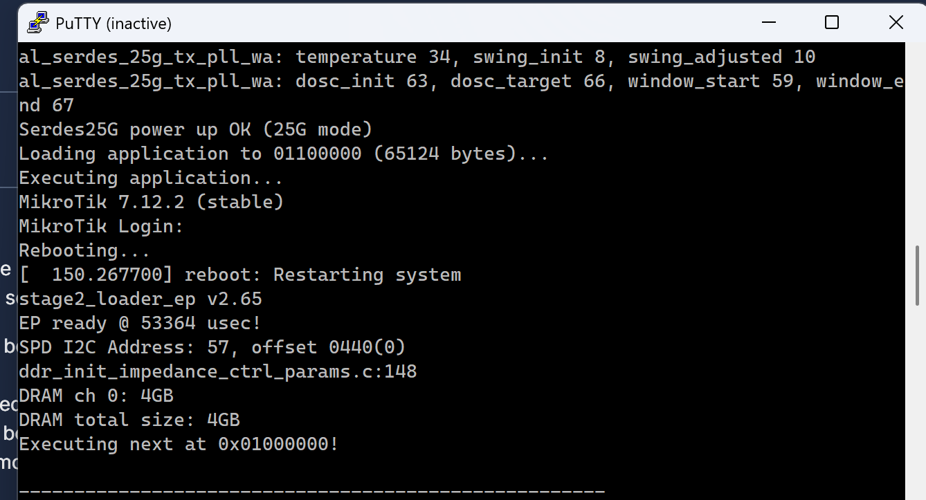

Also (and unrelated), for future models, it would be nice if it also had a serial port somewhere. Maybe via internal headers or something presented on the PCIe bus.

As for UART, I wouldn’t be surprised if it was on one of the headers, just not enabled by default (Mikrotik still keeps doing this annoying thing).
There are two unsoldered 10 pin headers on the PCB. I haven’t poked around, but my guess would be one is JTAG and other SPI+UART like on some other Mikrotik boards…
It might be possible to modify board config in flash memory to enable UART like on ARM boards (how-to is on openwrt wiki).
Serial port is at the 10pin. Tx is pin 7, Rx is probably pin 8 or 9 (haven’t fully probed it), 2 and 10 are GND.
Standard 3.3V, baud rate 115200
