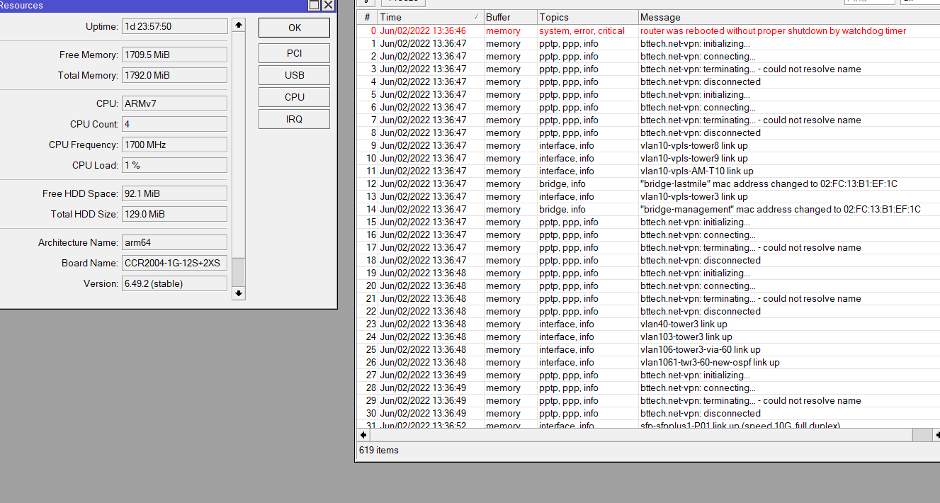

i have had this issue for over a year. It seemed to go away for 4 months or so with little to no reboots then bam its back and 3 do it within 5 hours. all routers are ccr 2004, 1 is brand new updated to 6.49, others are on 6.48. the only thing i was linking this to was OSPF bug but that was just based on reading i was doing and no proof. the only thing in the logs is (system,error,critical ) router was improperly shutdown by watchdog timer. like i said sometimes 2 or 3 times in a day then not for a month. but this is just wreaking havoc on my uptime.
i’m at a loss does anyone have any ideas? I want to get better logs by hooking up to console can we enable advanced logging to dump what is going on? i cant shut the watchdog off and let it hang until i can get to it that’s insane.
I posted this once but it didnt show up for some reason. I am getting reboots the only log i get is critical, error, system improper shutdown improperly by watchdog timer. watchdog is enabled with default settings with no added ip address. based on reading i was wondering if this was an ospf bug but not sure. I have tried 6.49 code and 48,old hardware and new hardware. what is weird is the problem seems to go away, then comes back with a vengeance and will hit 2 to 3 units within a day. sometimes no reboots for 30 days sometimes 1 device in 3 days.
this is driving me insane. how do i get more logs via console? is there advanced logging, is there a solution? this is wreaking havoc on my uptime! if anyone can help please let me know
First thing is to configure other logging destinations … memory gets cleared with reboot and any potential log entries from before reboot which might shed some light are gone.
that was why i had asked about console logging - can i get it to dump to physical console port and do i need to enable any advanced logging or extend timeouts on the console? this issue is rampant all over the place with tons of people having same issue. Has there been a core issue for the ccr2004 reboots from the watchdog?
Not sure about console logging … I’d go with logs written to disk files. With 10 log files (rotated as they fill in) and 1000 lines per log file logs will consume around 1MB of precious disk space in total (100kB per file). Depending on number of events logged such setup might contain more than one month worth of logs entries.
