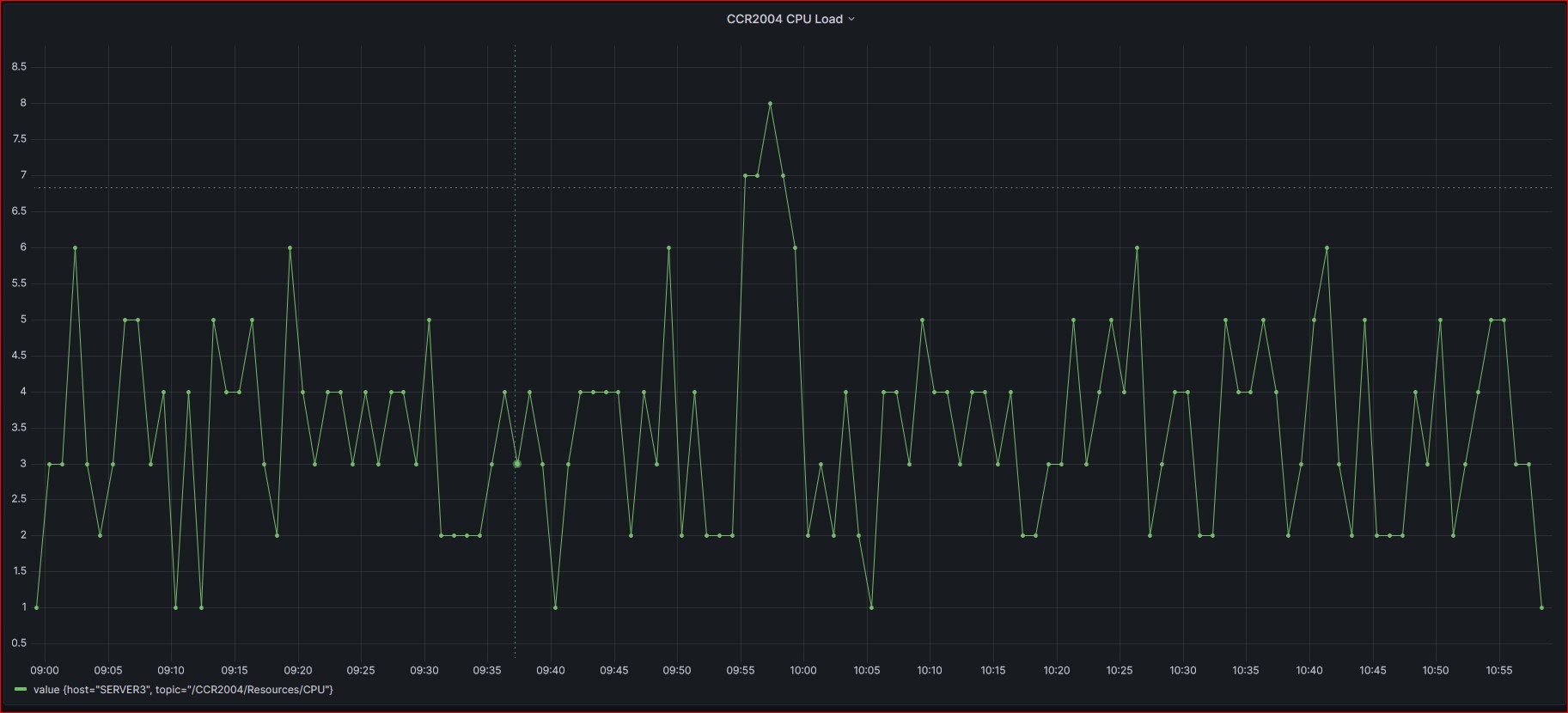

Here is CPU load graph (from Grafana)
Any version what happened?
Basically, the second 88E6191X switch chip restartet/reset, or the 10G link between it and the CPU was interrupted.

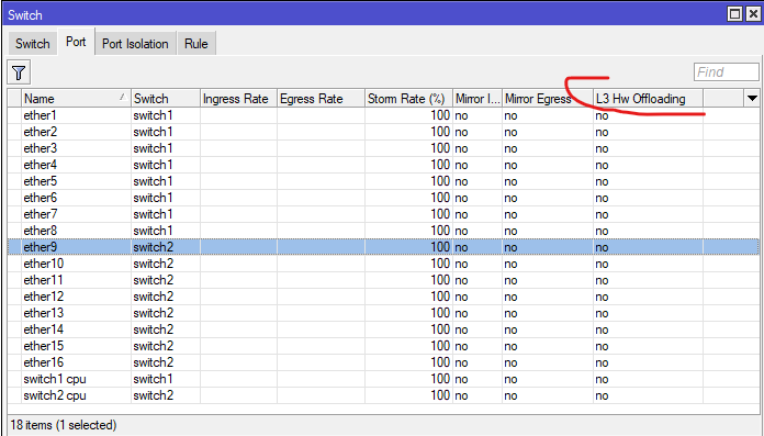

Are you using any hardware offloading functions on any of the ports 9 to 16?
I had no experience with hardware offloading yet, so I didn’t change default configuration concerning theses functions.
Just checked second switch settings and I see that it’s L3 hardware offloading is OFF
May I get some advice concerning hardware offloading? In what cases should I use it?
L3 hardware offloading is not supported in CCR2004.
