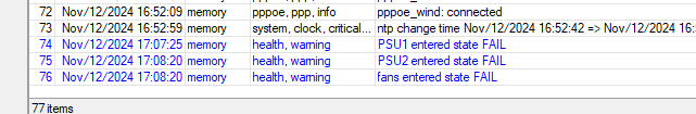

PSU entered state FAIL
fans entered state FAIL

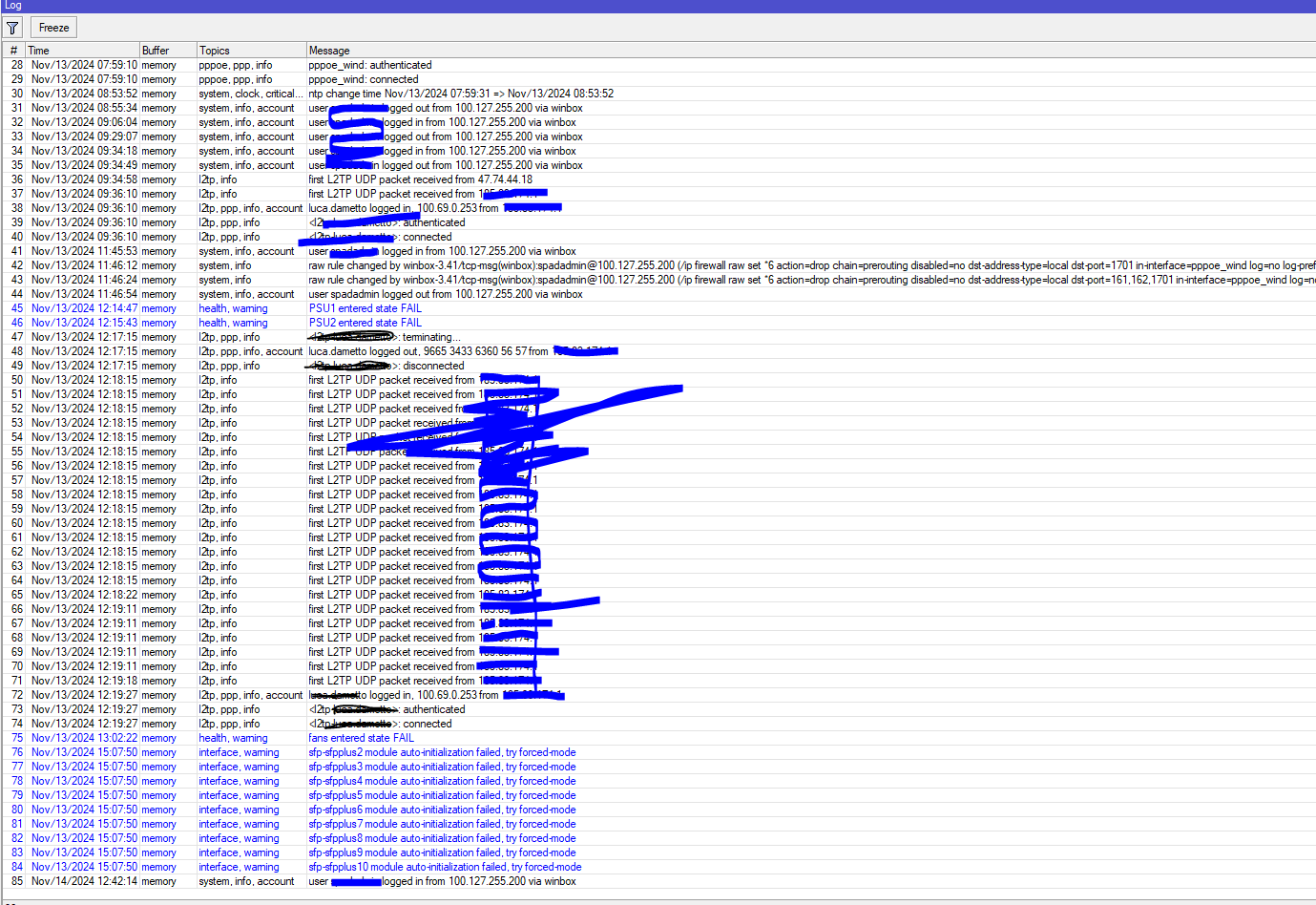

problems from time to time with our GPON module.
It did not change during update to recent ROS.
The issue is the GPON module,
change it and it will be OK.

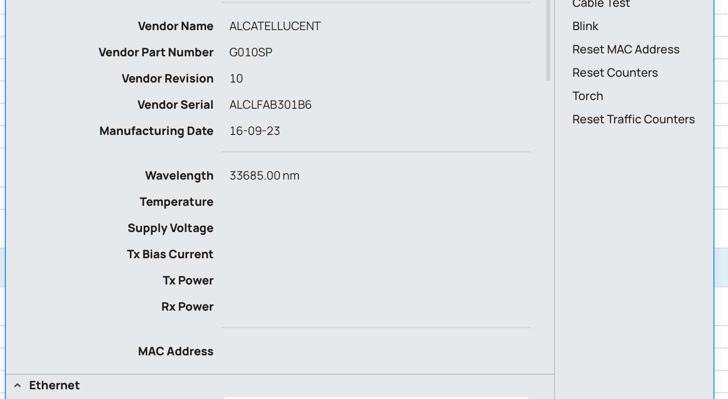

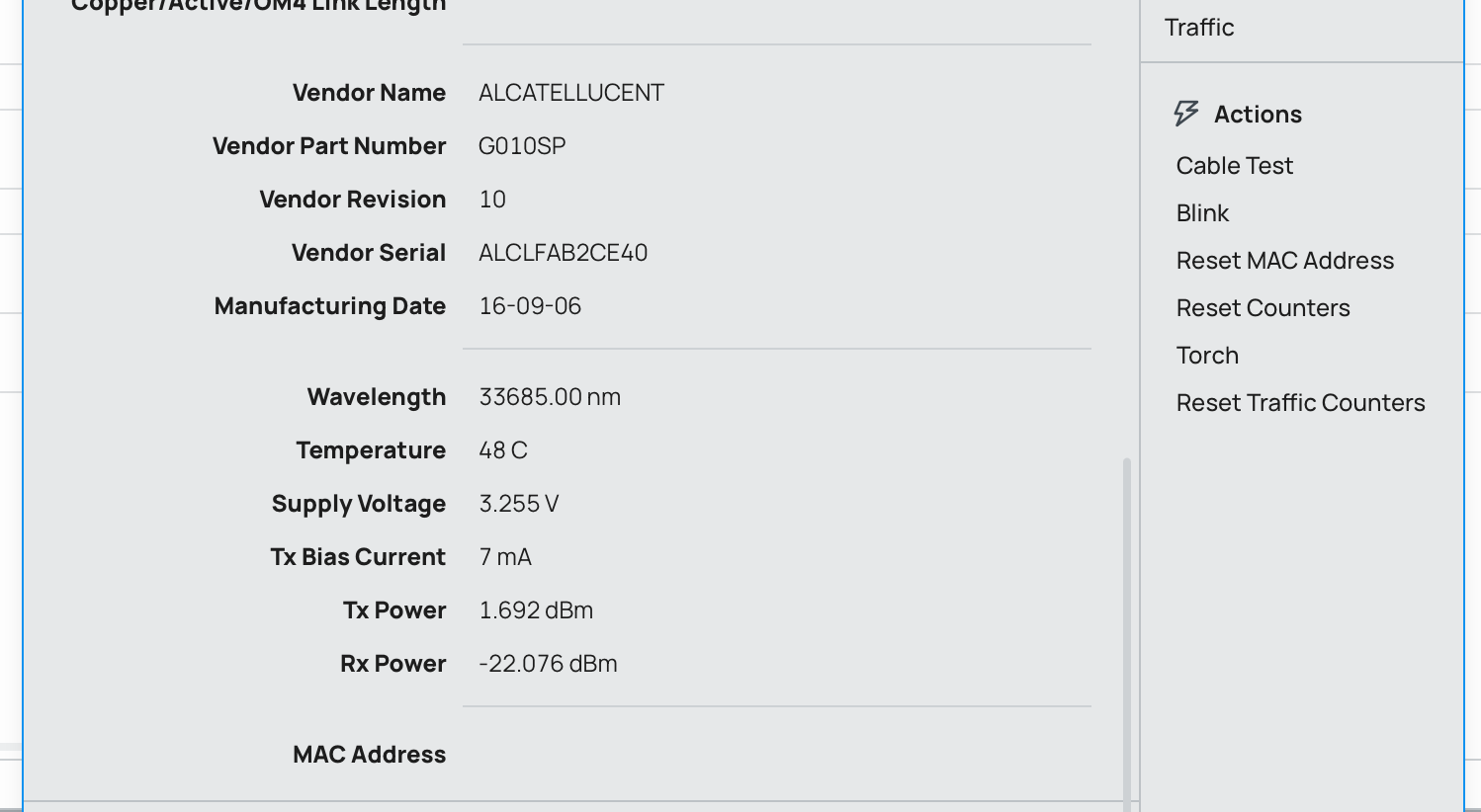

GPON MA5671A (FS Modded Firmware)
CRS309 has all the information
CCR2116 does not have it and PSU1&PSU2 and FAN errors occur.
attached screenshots
The issue is HOW the CCR and the HEX manages and access the SFP.
It is a matter of BUS path.
So, change the router and you will fix that specific issue.
