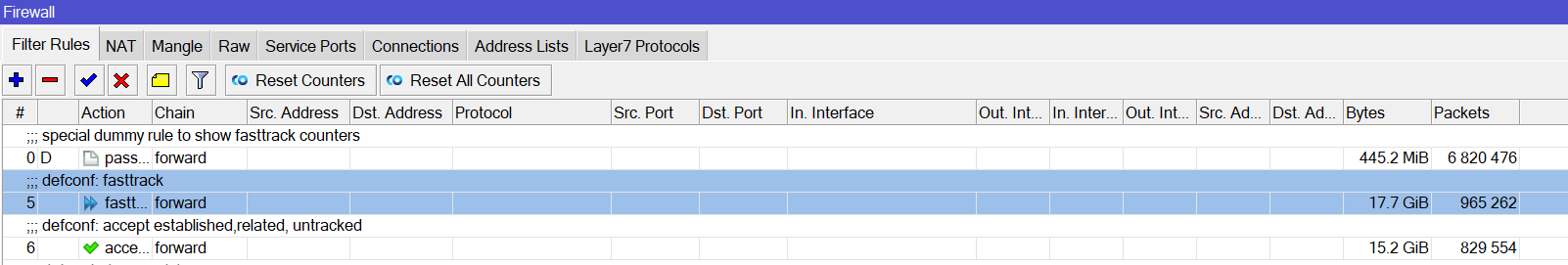

Do you have fasttrack enabled?
Yes The only ip filter rule enabled on my last test
However don’t know why fasttrack counter is showing only 445.2MiB?
Also this is traffic flowing between SFP+ ports(LAN → WAN) so the traffic needs to pass the CPU since SFP+ ports are connected individually to the CPU.
I am speculating I am hitting single core performance of the CPU but I can not prove it. If I run iperf3 with -P 6 I am able to reach close to 9 Gbits/sec

Got a response from Mikrotik and it was as I thought, the limit is the single core performance of one stream.
