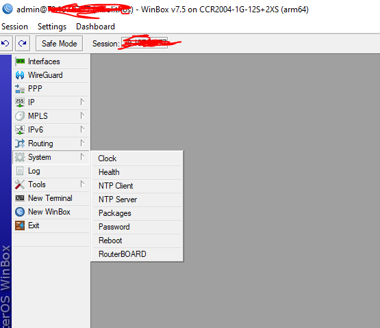

After upgrading a ccr2004-1G-12S+2XS to v7.5 stable I can see only 30-40% of the menus in winbox and some of them the moment I click on them winbox crashes.

Interfaces, ppp crashes and also submenus are limited
I found the solution.
I logged in via the web UI and I went to a menu with the skin designer which was also looking limited and I pressed the reset button that supposedly would reset only this menu options. The moment I pressed save everything returned back to normal on winbox
