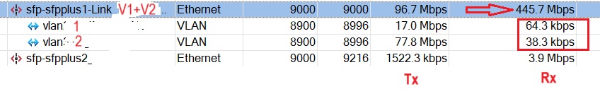

I have a CCR2116 CCR, and since I upgraded to ROS 7.17 it is incorrectly displaying the download on the vlan of an interface. On SFP+1 interface there are 2 vlan whose traffic is wrong. The traffic value per port is correct, the one displayed on the vlan is strange. I attach 2 pictures with the graph on that port , and also with the traffic rendering in Winbox.

VLAN traffic is traffic between device’s IP stack and that device. If device is used as a switch, then traffic shown for VLAN interfaces will be low.
Or is sfp-sfpplus1 being used in a “router on a stick” manner?
Do you have an ip addressing on the sfp+1 physical interface?
Without the configuration we can only guess… possible problems.
