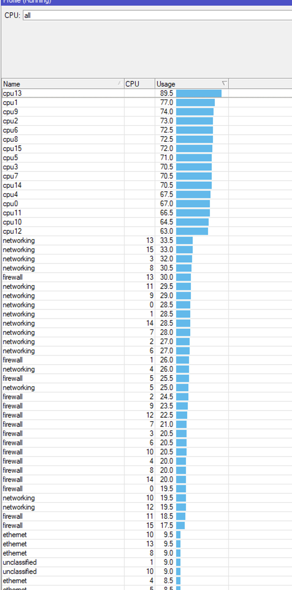

Looking for some help here. I am working on trying to diagnose why CPU’s are peaking around 80% when doing about 2-3Gbps and about 1-2million PPS. I have fasttrack enabled and configured properly (I THINK) and I wouldnt say anything special about my config.

I have attached a screenshot to view profile during peak moments. I have tried disabling the firewall rules entirely to see if that would help with the load, and it doesnt really have much effect. Can anyone help me out here? I am sure it is just a stupid configuration issue I am looking past. Certainly this thing can handle more! :smiley:
What version are you running?
For reference, my CCR2116’s (same 16-core processors) are hitting 2.5Gbps, 200Kpps, at 12%. So it could be a PPS issue more than a throughput issue. You want to figure out how to push as much as you can towards L3HW offload.
