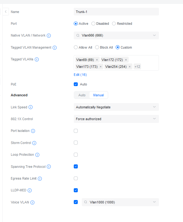

Hybrid seems to be what Unifi does as well.. where they just pass all vlan traffic, defined, known, or unknown..

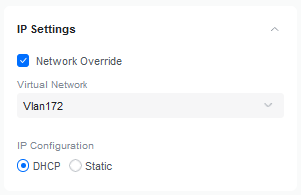

Attached is the unifi profile for the “trunks” and vlan1 is not included.. and the local device setting for management vlan 172..
