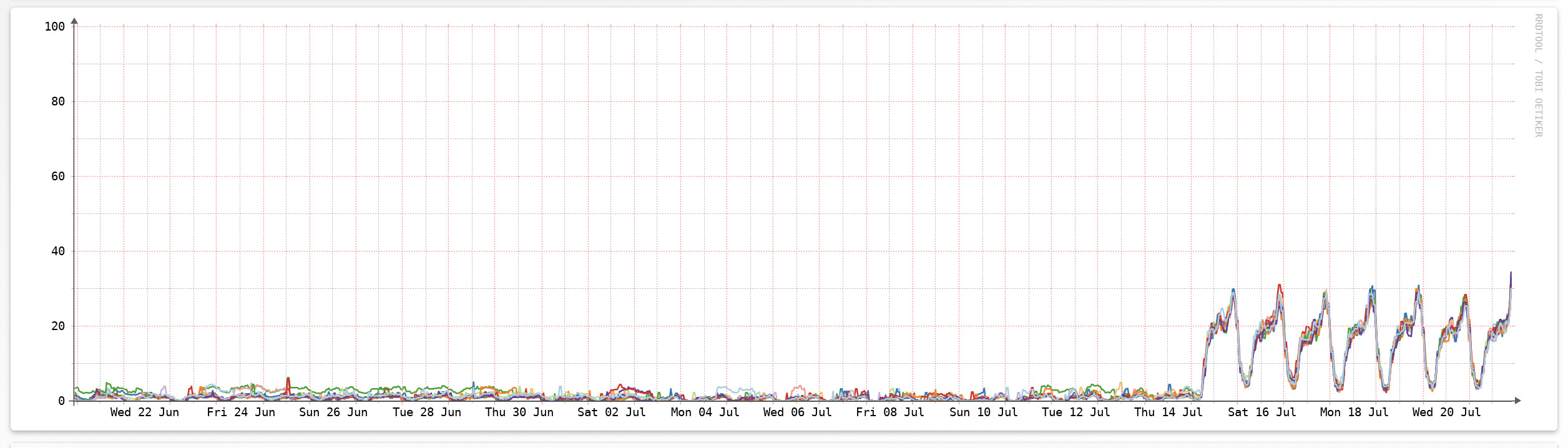

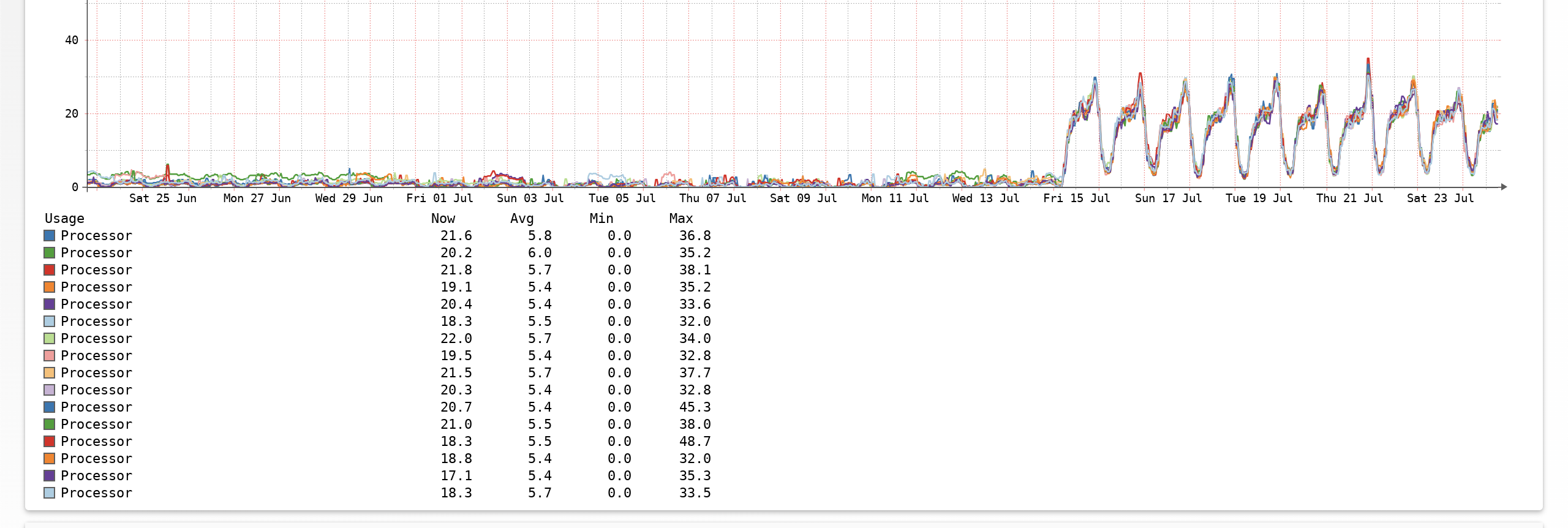

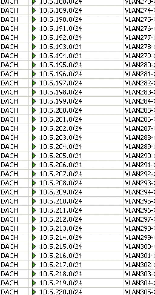

I’ve been using a ccr2216 with about 10 gigabits of internet traffic, and I was very happy with its performance as the processor didn’t go above 3%, and I like this knowing that consumers can surf the internet faster.
A few days ago it started to present a strange problem, I see that the processor went up to approximately 30% and the traffic that in winbox before was not seen through the VLANs can already be seen but only in the TX, in the RX no you can still see it, which means to me that the L3HW is now working only with the traffic that the router receives, but when it has to send it to the other interface, it uses the CPU to do so.

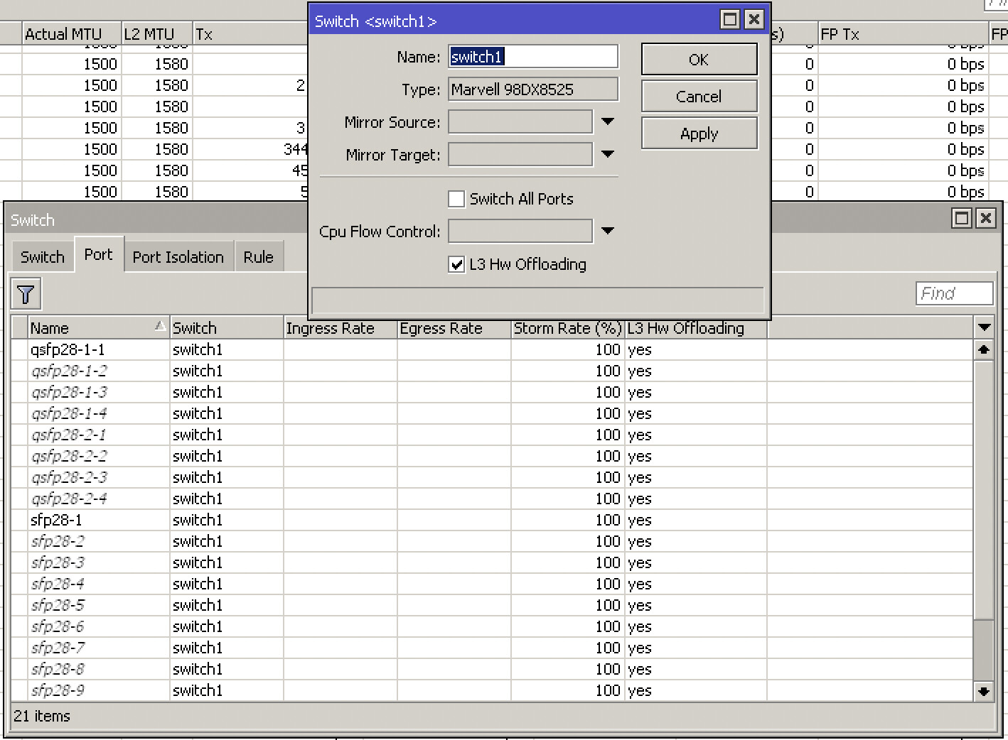

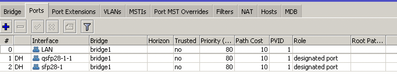

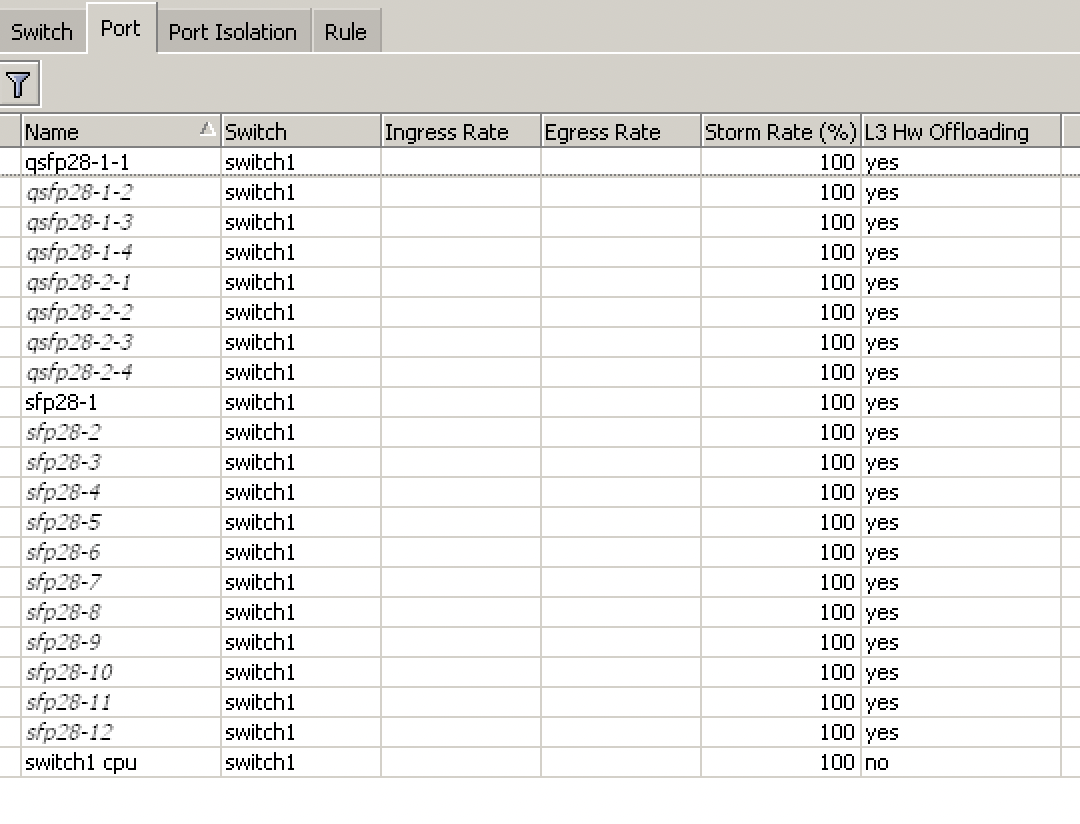

I have checked, the bridge is configured well, hosting the interfaces, both with DH flag, activated vlans filtering, and in Switch added the interfaces to L3 and activated L3HWoffloading, I have about 800 routes installed in the routing table, some static and others OSPF
I tried rebooting the router, and update to version 7.4Stable, but still the same problem.
There is a way to verify which routes the CPU is sending to the Switch, because apparently all the DACH routes are not being used by the Switch.
I attach configuration images and the change in the CPU usage graphs.

That the CPU is doing the routing work and not the L3 switch

Hi, thanks for you interest.
I also have an OSPF instance running on vlan2600 to advertise the networks connected to this router.
I have a question after studying the mikrotik documentation, is there a way to tell the router which routes to pass to the L3HW instead of everything passing to the L3HW when it is activated, something like (accept these routes and not the one not accepted.)
It is for example so that certain IPs that you want to block by firewall can go out to the processor and be blocked efficiently.

add disabled=no distance=1 dst-address=0.0.0.0/0 gateway=172.16.246.1 pref-src=0.0.0.0 routing-table=main scope=30 suppress-hw-offload=no target-scope=10
have you tried disabling this ?
/interface bridge settings
set use-ip-firewall-for-vlan=yes
i dont see lines enabling L3 offload on ports
/interface/ethernet/switch/port set [find] l3-hw-offloading=yes
Hi thanks
If you are referring to my question about blocking IP, yes I have tried but when the connections go to L3HW the CPU can no longer see them and it is not that useful, so I was asking if there is a way to classify what I do want and what I don’t I wish it would go to L3HW.
When you enable this, all ports are added to the switch.
Your configuration looks fine on the first look, but it is hard to tell due to its size - maybe I have missed something.
Here are some remarks:
  • Check the Route Configuration for controlling which routes to offload.
  • Do NOT enable use-ip-firewall or use-ip-firewall-for-vlan in bridge settings unless you want to mess up hardware offloading. Use Switch Rules (ACL) instead. ACL rules are hw-offloaded and, therefore, cause no performance drawback.
  • For Inter-VLAN routing, make sure that the bridge interface itself is a tagged member of the VLANs. In your case VLAN3500-TR069 is missing that option, I’m not sure if it’s intended.
