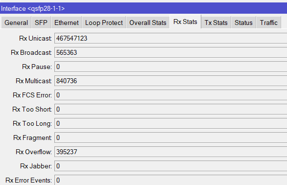

Form the image, appear a MTU error.
Post the interface config on both sides.
How can you tell that ?
Because of different l2mtu between qsfp and ether1 port ?
Not, for the RX overflow, but on image you see only one side…
This is CCR2216

This is not a mtu issue ,i guess. also half of the L2 ckt terminated in ccr are from telcos. and are working fine in 1072 without doing any changes.
We are experiencing the same, the 2216 was working fine for two weeks then no SFP TX traffic with high RX overflow packets. Running 7.10.1.
The only interface that does work is ether1, which is not connected to the switch chip.
