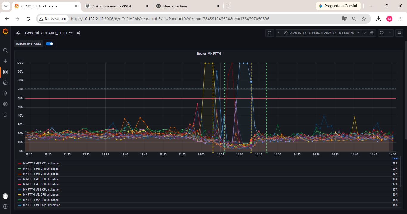

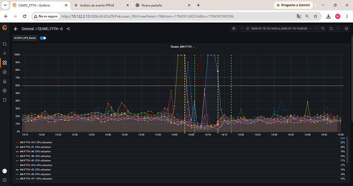

Update: the issue occurred again today after upgrading the CCR2216 to RouterOS 7.21.5 Long-term.
The event started at approximately 14:01 local time (UTC-3) and lasted several minutes. During the incident, individual CPU cores reached 90–100% utilization, while the remaining cores stayed relatively low.
The firewall detection rules, bot-detection rules and related scripts/schedulers were disabled before the event, so the problem still occurs without that additional firewall load.
We do not use OSPF for the PPPoE client routes, and we do not use MASQUERADE. NAT is configured with explicit SRC-NAT rules.
Approximately 1,300 PPPoE sessions are active on the CCR2216. A new supout.rif was generated immediately after the event and has already been sent to MikroTik Support under ticket SUP-219878.
The CPU graph suggests that a single-core or poorly distributed RouterOS task becomes saturated during the reconnection wave.
