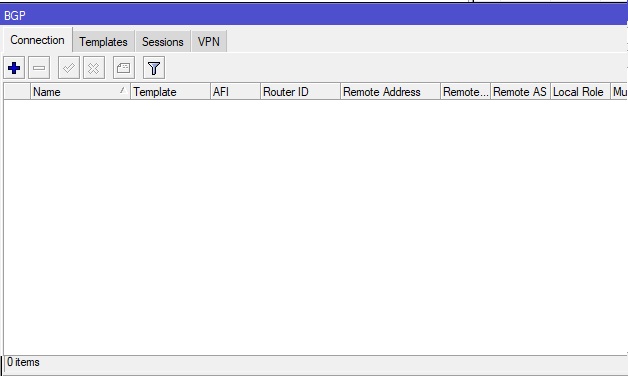

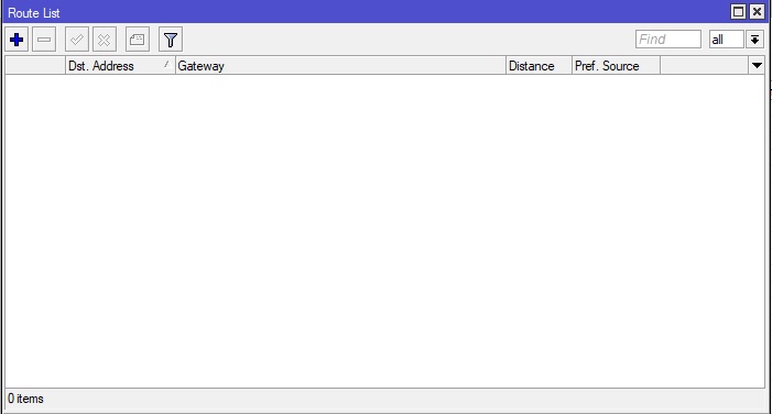

I wanted to find out if anyone else has had a similar issue on their CCR2216 that does BGP and OSPF:
Issue: From boot after a few hours the route table crashes/hangs (does not update or remove routes), we can’t view the route table in Winbox or terminal (hangs in the terminal when you run any command) and the same for bgp settings.
This only started after we upgraded from a CCR1072 v6 to the CCR2216 v7.
We have tested this on many v7 ROS versions up to 7.10
I have attached 2x pictures.
Any feedback from the Mikrotik community would be greatly appreciated.

We are not using BGP or OSPF but we have seen similar problems with the routing table crashing / going missing after rebooting. To date we have not been able to pin down the problem but its led to some serious doubts about our ability to apply new packages and reboot our cores, a very large problem.
Sometimes the table will restore after a couple of hard reboots but most of the time we have to wipe and reconfigure to resolve the problem. It seems to be something more prevalent when we have applied our configurations vs running them factory stock, where reboots do not seem to be a major issue.
