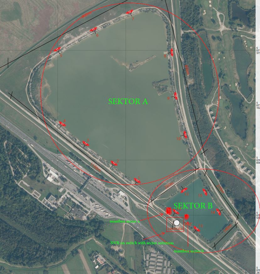

Hi we have a project with cctv poles, which we cannot finalize because of problems with conectivity. On nvr cameras are sometime show sometime not assuming because of loosing connection because of not good configuration.
Each pole have 2 x cctv IP dahua 5mp camera and sxt mikrotik sxt2 lite antena, connected in gigabit 5 port switch.Total 15 poles - 30 cameras
In base station house on roof we put 2 sector antenas - MikroTik RBD22UGS-5HPacD2HnD-15S, mANTBox 52 15s Dual Band Sector Antenna for position A and Position B.(left sector and right sector) and NVR for cameras connected in 8port gigabit poe switch.
Al antenna are on fix ip adress including cctv cameras.

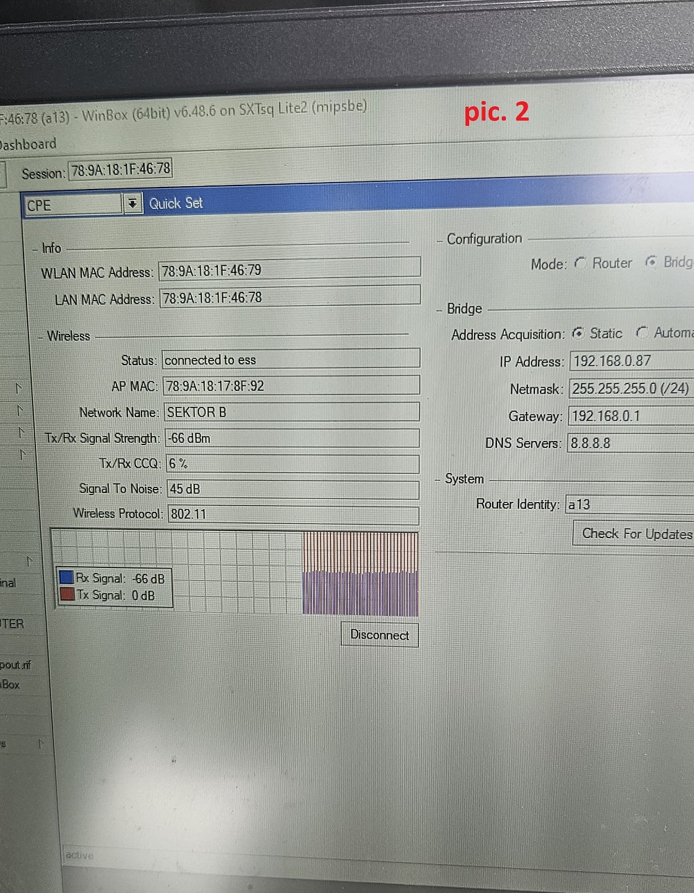

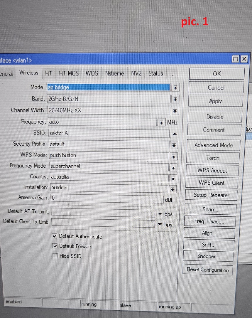

Sector antena are configured as ap bridge(pic 1) , and sxt2 like station bridge(cpe - check pic 2)
Range of signal is from -60to - 75 db (what is working optimal and min/max range?)

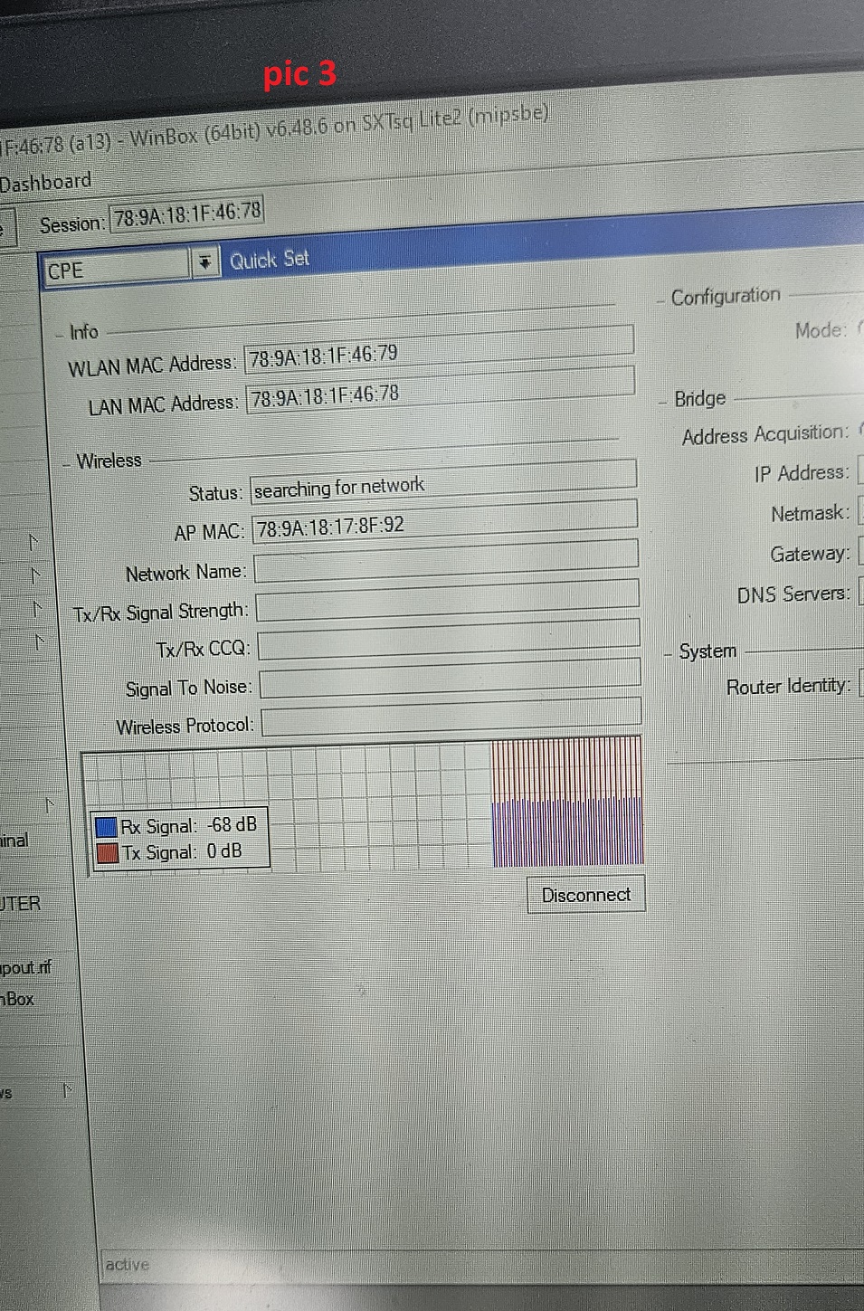

Some antennas connect to sector antennas without problems, some connects and just disconnect from time to time (se picture 3)
some poles connect to sector antennas some just loose connection.
strange thing is when i connect on switch on sector antenna i se only 2 poles antennas even 7 poles work normal
anyone have any advice for setting up.

Is there anyway you can physically tie together some of the devices on the same side of the water and thus reduce the number of RF connections.
Then you could possibly use 60Ghz connections for the transfer of ( better protocols indicated above ).
