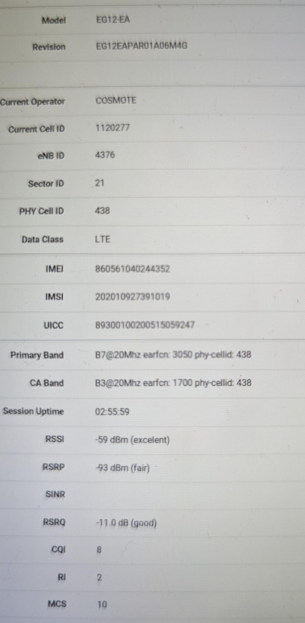

I want to lock my CHATEAU on the specific cells (see screenshot)
Primary Band B7@20Mhz earfcn: 3050 phy-cellid: 438
CA Band B3@20Mhz earfcn: 1700 phy-cellid: 438
When i enter the following command i get output error
interface/lte/at-chat lte1 input=“at+qnwlock=“common/4g”,1,3050,438”
output: ERROR

I guess you have to escape the inner quotes:
/interface/lte/at-chat lte1 input="at+qnwlock=\"common/4g\",1,3050,438"
