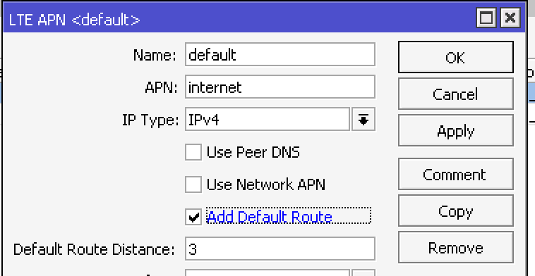

For LTE to work with Cosmote you have to disable “Use Network APN” and manually enter “Internet”. I also set Ip Type to IPv4, but I’m not sure it’s necessary.
This is expected on 3G/LTE networks, you have to enter predefined APN (even if it’s the most popular “internet” value).

The important part of making Mikrotik LTE device run in Cosmote network is the capital “I” in the APN “Internet”.
It fails with APN “internet”, and as already mentioned, fails with “Use network APN”
The TTL magic mentioned above is not needed as COSMOTE does not abuse TTL the way other ISP do.
What made it hard to debug:
  • A Bulgarian SIM card (A1.bg or vivacom.bg) with roaming enabled works great in a Mikrotik router in Greece.
  • Both Cosmote and Vodafone cards work in whatever phone or tablet, incl. hotspot for another devices.
  • Both Cosmote and Vodafone cards fail in Mikrotik in similar manner - the LTE interface registers in the network, shows good signal, gets IP and does not return any traffic.
  • Modern mobile devices silently accept the configurationn messages from the provider.
  • Bulgarian mobile operators (all 3 of them) accept whatever you write in the APN field and you get internet access. This may make one think that this setting is of no importance.
