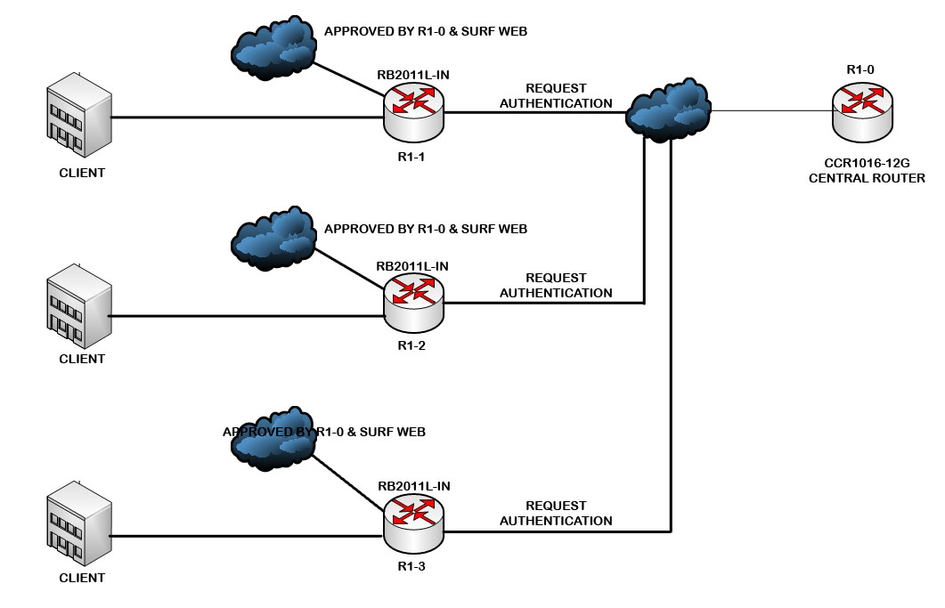

Description of attached layout:
R1-0 is my radius server. With User Manager installed at remote location more than any wireless or wired network can reach or at least it is not reasonable to lay cable 100s of KM.
R1-1, R1-2 and R2-3 each have their internet access but need to be authenticated by R1-0.
When client entered their username and password, they can user their hotspot internet to access the web.
Anyone can help me with this. How to achieve this. Explain it to me in plain english because I’m not a computer genius. Thank you in advance.

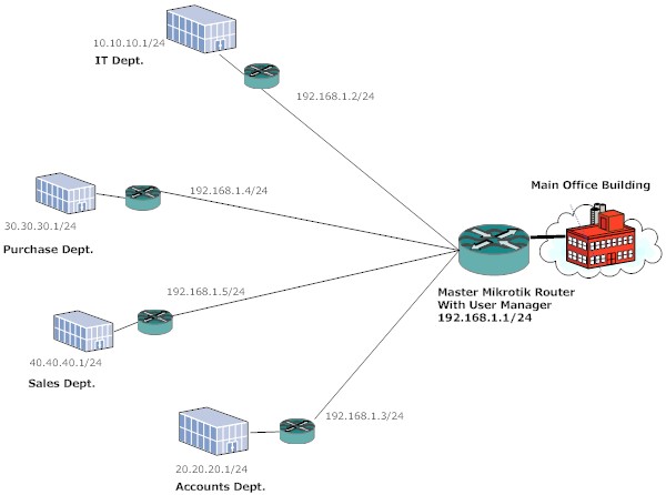

Like this…
