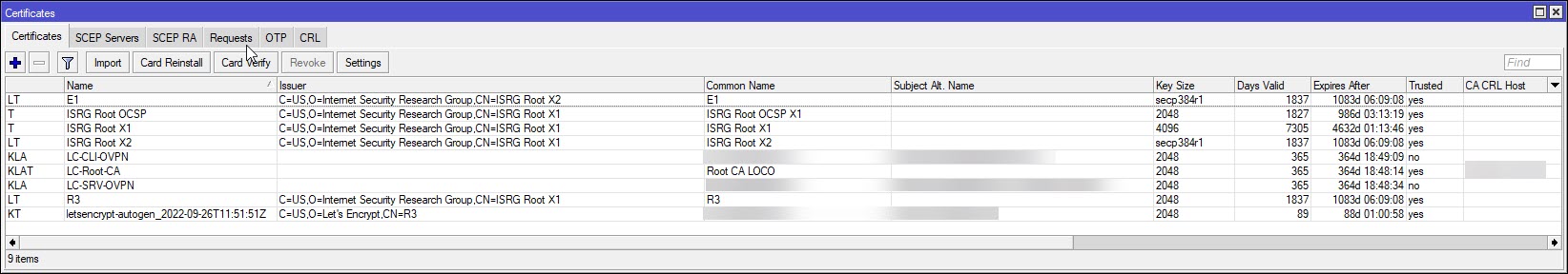

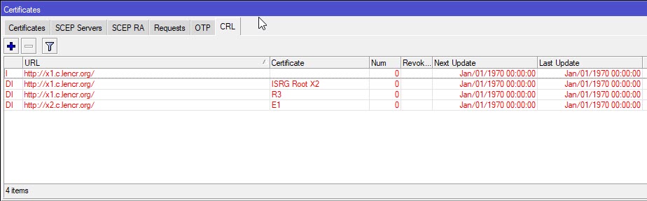

Certificate CRL issue | Got CRL with a bad signature
Does anyone know how to solve this issue?
Regards,
